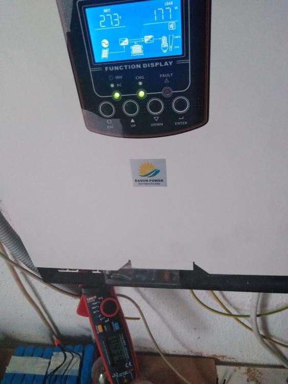

December 12, 20187 yr @gabriel In picture above, you can see inverter is in "battery mode" but, there is current trough AC IN Line, you can see the measurement of current, 0,438 A. If you Switch Off AC IN Line, that current, which is related to Reactive Power, should "go" to the inverter.

December 14, 20187 yr I suspect both @Javi Martínez and @Coulomb are confused here. There is no way that an Axpert can inject reactive power, or any kind of power, into the grid. The Axpert draws reactive power from the grid, even in battery mode, because it has capacitors connected across the grid. This is perfectly normal. 0.4 A is not surprising. I suspect Coulomb mixed up his true, reactive and apparent powers when he wrote: "Axperts will never admit that their measurements result in more reactive power than real power". First, Axperts don't attempt to display reactive power (VAr) at all, and second, real power (W) is always the smallest of the two numbers that it does display. I suspect he really meant to write "Axperts will never admit that their measurements occasionally show more real power (W) than apparent power (VA)". And neither should they, since it is physically impossible for real power to be greater than apparent power. But this seems, to me, completely irrelevant to either of the two phenomena that Javi reports. The second phenomenon that Javi reports is that the apparent power (VA) number suddenly drops to becomes the same as the true power (W) number, simply by connecting the grid to the Axpert's grid input, with no change to the load, and while still powering the load from the battery, not the grid. This is indeed strange. But I don't believe it has anything to do with the fact that the Axpert draws a little reactive current from the grid, even when in battery mode and not charging from the grid. My PIP-4048MS (equivalent to the 4 kW Axpert MKS 5K-48) continues to show apparent power (VA) greater than true power (W) no matter whether the grid is connected or not, and no matter whether the loads are powered from the battery or the grid. This sounds like a bug in the firmware. Javi, what make and model is your inverter, and what U1 firmware version does it have? Edited December 14, 20187 yr by weber
December 14, 20187 yr Brand:EASUN POWER Model:ISolar SPV 3K ['VERFW:00004.24'] ['VERFW2:00003.27;'] But I´ve seen you are right. I thought measurement from inverter were useful but they aren´t. I´ve done the test again with an amp meter and is the same current on grid or not. @weber Edited December 14, 20187 yr by Javi Martínez
