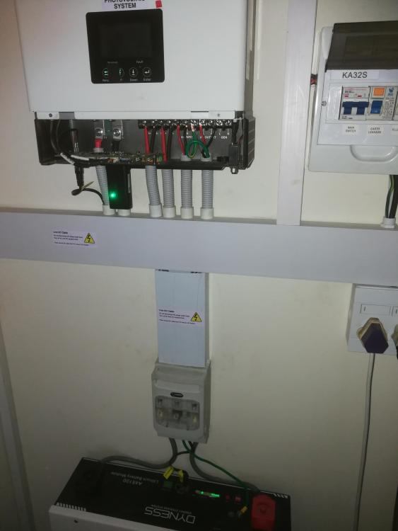

I did the same - I do not have the funds to hire someone to do something I can do myself. With lots of help from Google and Youtube.
