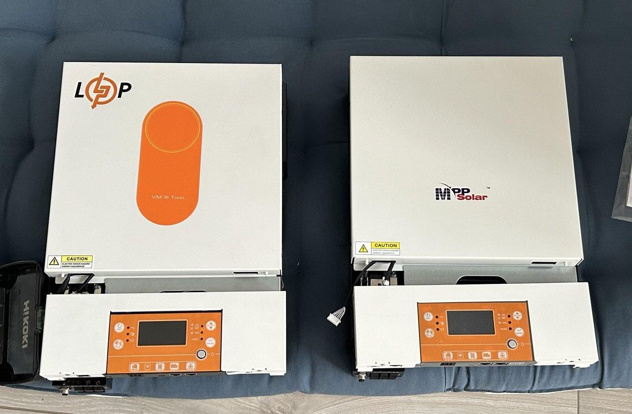

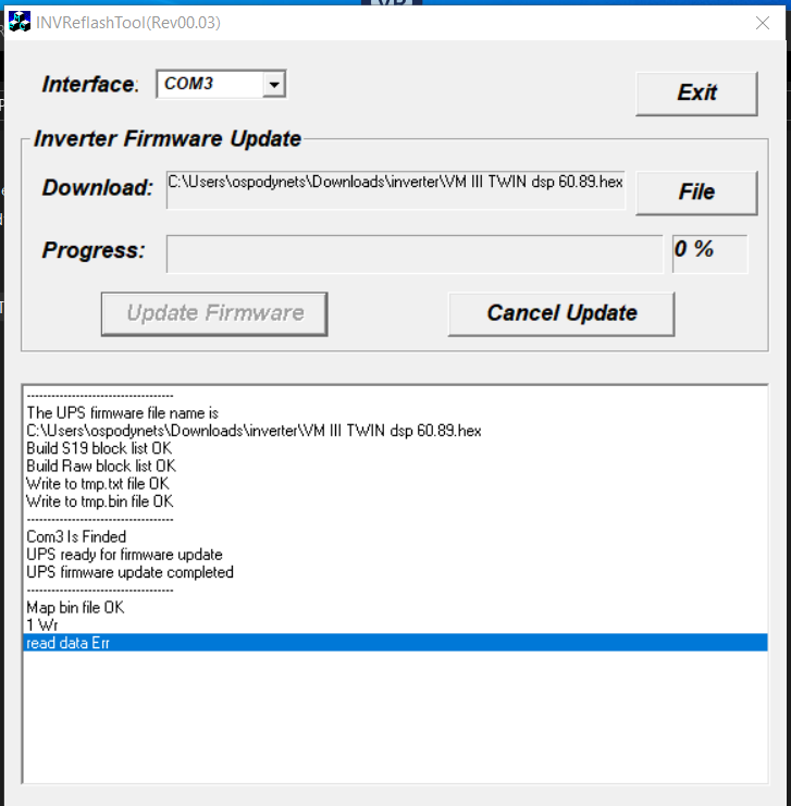

August 2, 20242 yr Hello there, I decided to use this topic, since here I found a source for the Control Board which most likely I will need... (Thanks @vdml) I have similar inverter but with 4K power (Locally LogicPower VM III Twin 4K with removable display) Initially it was with U1 56.09 and U2 25.06 firmware. Following different directions from this forum I found needed how-tos and software updates (Thanks @Coulomb!) (I wanted less noisy fans, looked for a fix for premature float bug), but it seems, I bricked it completely. I started the update with "VM III TWIN dsp 68.04" using DSP reflash tool and USB data cable connection. This cable I've been using a lot of times for flashing and setting Speedybee, Pixhawk drones with Betaflight, Ardupilot, everything was fine. The flashing of the inverter was started successfully but failed after 30 seconds with Connection Error. Now when I turn on the inverter, even coolers are not starting, after Display countdown, it shows "Fault 32". I tried to reflash it with USB to RS232 cable, created a bypass cable, to avoid using Display module. The outcome is the same - the flashing hangs after read err (See screenshot). I was looking for the way how to debrick it, but I ended up here and, looks like, I will need to purchase this control board. But before that I would like to ensure, maybe is there a way to reanimate my control board, maybe by reflashing it by some other bootloader, which will be consistent with the latest firmware for this inverter.. Thanks, Oleg
August 3, 20242 yr 17 hours ago, runtimeassertion said: I started the update with "VM III TWIN dsp 68.04" It looks like you are using 60.89 from the screen shot. I don't yet understand what the difference is between the 56.xx firmwares and the 60.xx firmwares. By the looks, it's something important 😲 I would first try to recover the DSP by reflashing with the latest 56.xx that you can find, probably 56.72. 17 hours ago, runtimeassertion said: I was looking for the way how to debrick it... Patiently retrying the reflash, making sure you have the right firmware file, possibly varying the timing from switch on of the inverter to pressing the update button on the reflash tool, as per my "if you think your inverter is bricked" post. Your inverter is a clone (note the cent symbols rather than the Greek letter phi for "phase" on the label). That reduces the chances of success. 17 hours ago, runtimeassertion said: maybe is there a way to reanimate my control board, maybe by reflashing it by some other bootloader... The bootloader is not changed by an ordinary reflash, successful or otherwise. The 56.xx and 60.xx firmwares use the same reflash command, so their target machines probably have the same bootloader. Edited August 3, 20242 yr by Coulomb
August 3, 20242 yr Hi @Coulomb, Thanks a lot for the reply! I tried what you advised and it works now! Using your bypass cable directly flashing to the inverter, I started from 56.72 and it was succeeded. Then I tried again 60.89 and 68.04 - no luck (the process was failing at the middle with read error), so I reflashed on 56.72 and then tried 60.04. And it worked! Then I tried sequentially all 60.XX and ended with 68.04 successfully. I couldn't imaging that if bootloader was the same the order of flashing firmwares matters. Now I finally enjoy silent fans! 3 hours ago, Coulomb said: Your inverter is a clone Hmmm, honestly I thought that all these inverters are OEM and available from different brands( Voltronic, Axioma, QPower, LogicPower etc) and were manufactured in the same facility somewhere in mainland China (OUYAD?), but now I see that originally it was from Taiwan, but then clones were produced But in any event, even if it is a clone, it looks robust and reliable inside. Testing now in different modes... Thanks again for help!
August 3, 20242 yr 18 hours ago, runtimeassertion said: Hmmm, honestly I thought that all these inverters are OEM and available from different brands( Voltronic, Axioma, QPower, LogicPower etc) and were manufactured in the same facility somewhere in mainland China (OUYAD?), Voltronic calls their system ODM (Original Design Manufacturer?). Voltronics' design headquarters are in Taiwan, and their manufacturing is on mainland China. So both the real Voltronics inverters and the clones are made in China (as is nearly everything in the last decade or two). But the clones are made to unknown standards, and they copy the Voltronics firmware without paying for it (as far as I know). Voltronics won't help any owners directly, only via the reseller. And the resellers won't talk to clone owners at all. So you are taking a big risk in my opinion buying a clone. Some of them can't even be firmware updated at all, some stop with fault code 90 after a few weeks of operation, and no doubt some as good as the real thing. But how do you know which ones are the good ones? What if you need a firmware update, and it's not on the internet? It might appear next week, but it might never appear. Speaking of firmwares that don't appear: I don't have 68.04 (unless that's a typo) in my collection. [ Edit: Duh! I've been reading it! Brsin spasm. ] Would you be able to upload it here as an attachment? I'm glad you got yours going. Edited August 4, 20242 yr by Coulomb
August 3, 20242 yr 27 minutes ago, Coulomb said: Would you be able to upload it here as an attachment? Sure, I found it in the forum here: It was said that it introduces smart fan control, and now I can really observe this. Thanks for the explanations about these inverters. If I would have this information, probably I'd chose original version. I didn't have enough time, I needed the backup power urgently due to the critical situation in power grid and the stock was almost empty everywhere in the country.. As a software developer I wouldn't like if my software was stolen and sold under other names without any fees. I don't get why they use the same case color naming, is it legal at all to sell it worldwide, offering custom labeling...

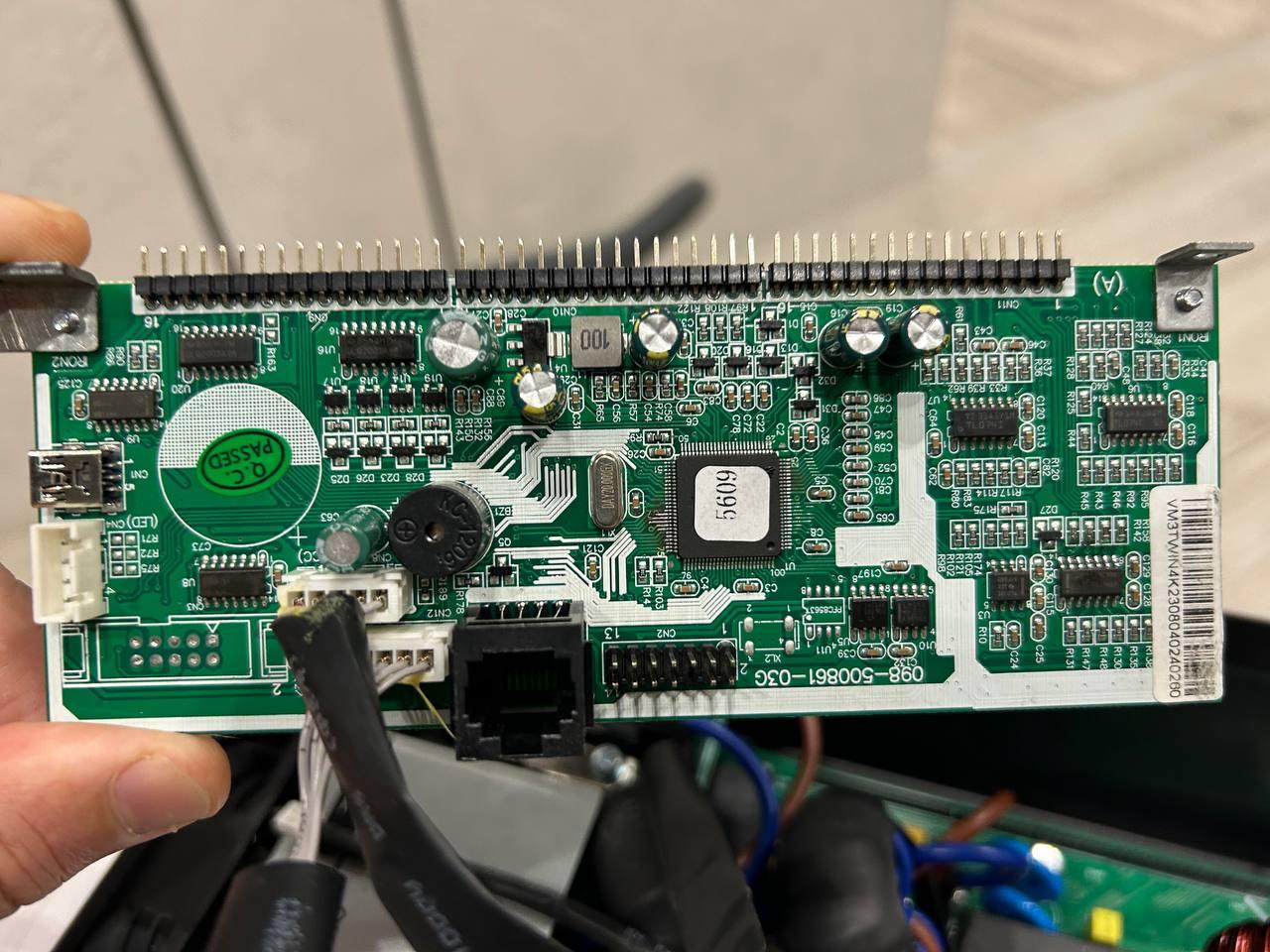

September 1, 20241 yr Got my new Pip-4024MT today. The difference is huge! I didn't fully open it, but spotted clearcoat finish at the pcb, bigger electrolytes and lots of different thingys which make it more solid. It works fine, switches faster when power goes off, produces less splatter sounds while generating output. It came with U1 60.08 U2 25.12. I decided to update it to the latest firmware found here: U1 60.95. And this time update was like described, through the display module, without any error from the first try. A little fly in the ointment is the "premature float bug". Now it stops charging when voltage is float (27.2 for my case). But it really stops charging, so no longer pulses 0 - 3A. Now I tend to think, it might be related with missing BMS connection and using my LiFePo AGMlike style. - It can't detect when charging is finished? Once I have other battery to test, I'll check it. In any event, I'm glad to invest in the original device and have it here!
