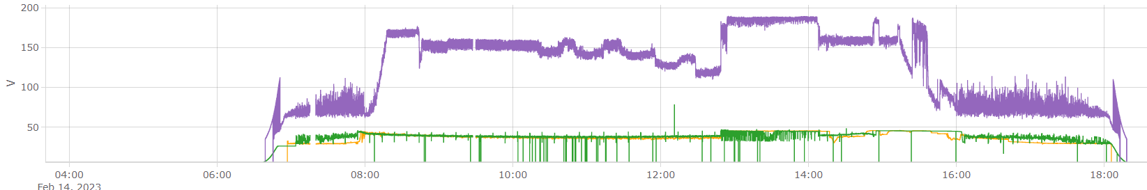

I have bought this inverter  Axpert VM III TWIN but i have some issue with the mppt because at the morning oscillate from 0v to VOC 180v (4s 550w solar panel), the production start when there are the red arrowimage.png
in the aftenoon the voltage go down and it stack to 60v, purple line is the same solare panel of the 4 series connected to the inverter but it is connected to a victron mppt 100/20 image.png
Now i have this firmaware
U1 56.05 U2 25.05
@mafiose13 do you have the same issue when the sun go up e when it go down?
Hello, the issue on my end is not  oscillation/fluctuation, it's a steady increase in voltage up to 118-120v, stuck at that for a while with mediocre PV output 1-10W, then sharp shoot voltage to 260-270, the  opposite happens in afternoon, sharp drop and lingers at 120. This is much much worse on cloudy days. Hence, most are calling it the "stuck @..."

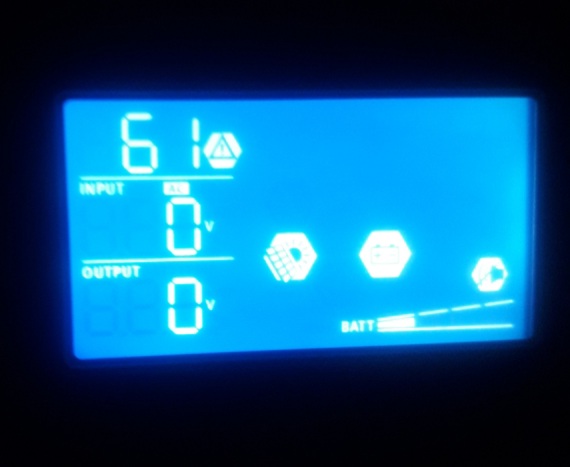

Hi!
I'm trying to connect the Axpert VMIII Twin 4K to the Felicitysolar LPBF2400-M lithium battery, but no luck...
I tried everything and I'm almost sure that the problem is in the firmware...
So, I made the communication cable according to the instructions:
inverter 3 >> 5 (BMS port on Battery)
inverter 5 >> 6 (BMS port on battery)
And, I'm trying with all options/settings in Axpert's program 05: Pyl, Lib and Lic. It doesn't work with any option, it always gives error 61...
Further, I generally have a problem with communication with that model of Axpert...
Watchpower works fine with Axpert VP/VM 3KVA, also with VMIII-5000 48V, but won't with VMIII-Twin 4K. Neither via original RS-232 cable, nor via WiFi...
I even tried the USB connection from the PC. Does not work. Again Firmware...?
Maybe anyone can help me?

3 hours ago, Mika said:
Hi!
I have this happening with many voltronics as well connecting to 24v or 48v Felicity lithium. maybe someone can help figuring it out. If you don't get responses, can you put it up in the battery/thread or make it its own thread to get the attention needed.
Having had a quick look at the protocol, it doesn't seem like it's Pylontech. I thought it might be LIB or LIC, but you've tried both of those. I assume you've waited about 2 minutes for each; the manual says it takes about a minute to connect (seems really slow to me).
I know that later display firmwares for some models have more BMS protocol options. It would be really helpful to find out what protocol the Felicitysolar BMS uses. A quick search was not fruitful. It may be that a later display firmware will have the BMS protocol you need.

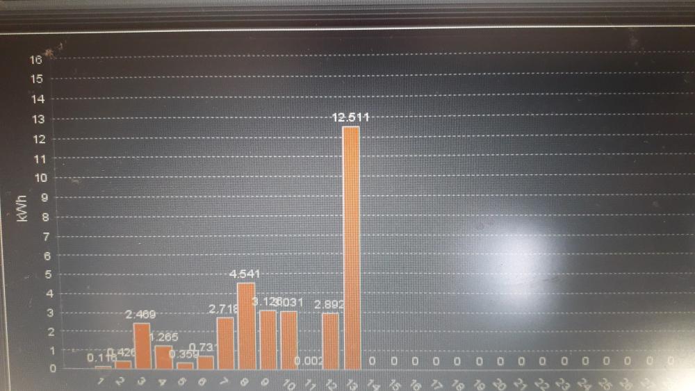

So guys I want to report back something positive. After struggling for quite sometime on this particular installation, I decided to remove those panels (6x550w jinkos), move them to the building's rooftop, make a metal chassis with "perfect" orientation (Dead south 180) n Azimuth (35) for the location. Previously west facing @ 15 degree tilt.
Max PV output at peak previously was 1580-1600 watts!
Max PV output 30min pre-peak today post move was 3017 watts!
We were averaging mediocre 2.5kw/day generation....we averaged a whopping 12.5kw today...5 Fold  increase.....WOW!
It's not all & always firmware issues...

20 hours ago, lucass said:
are there any parameters to eliminate the purple spike and flat area at 60v in the morning and evening?
Sorry, I don't know; I'm still confused about what's the best way to fix this MPPT bug. Once that is determined, actually patching it isn't all that hard.
My impression is that most of the latest patches don't lose much real power at the start and end of the day.
