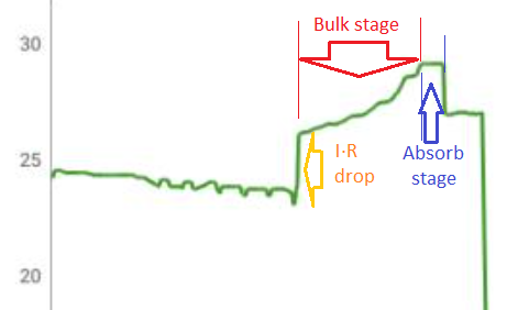

Ah, you're confusing bulk and absorb stages:
The bulk stage is where the bulk of the charging takes place. How long the battery stays in bulk stage depends on how discharged it was, and the net charge current (basically solar power less load power). I just assumed that the battery was more discharged in the second graph than the first. I don't understand why you seem to be getting consistently longer bulk stages in FLD versus USE battery types.
Can you check the battery charge current for each? I can't see why they would be different.
Maybe in USE mode, you are somehow getting a much larger charge current, and somehow that's causing the BMS to do something strange.
