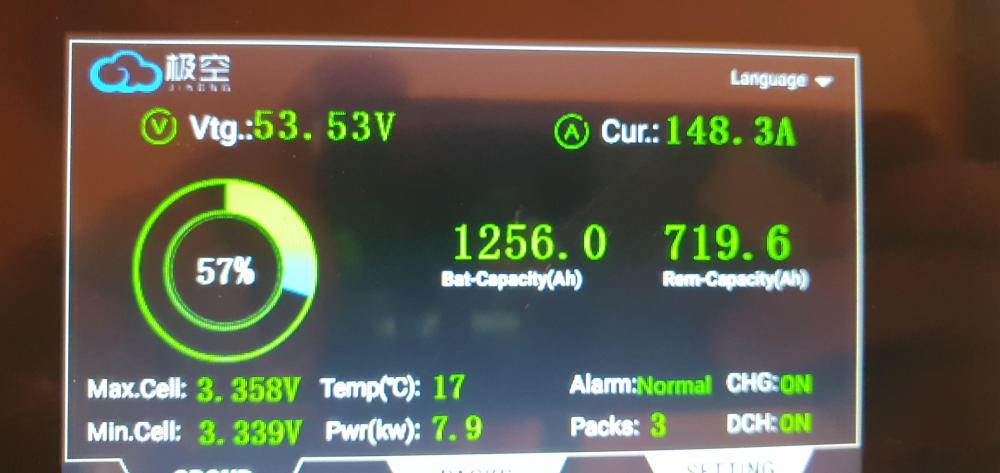

I apologize for interfering, but I have direct oversight of this particular firmware.
On one of my inverters I had factory firmware 64.03 and I had the problem with it getting
stuck at 90 volts. I uploaded patch 264.62 prepared by @Coulomb and since then the inverter
has worked wonderfully. The MPPT controller starts as soon as the current passes 0.2 amps
and the yield has increased significantly. I charge the batteries from solar energy with
145 amps. It also works great in cloudy weather. I have uploaded this patch to several inverters
and everything is fine. Be careful with the cables when uploading the firmware. Good luck!

I use 264.62 and I have no problem with charging from a 145 amp photovoltaic system. I haven't tried it on the grid because I'm completely off grid. My inverter looks like this, but it's still a copy of Voltronic. I've also uploaded the patch to a few other inverters that look like this and their charging current is over 130 amps.
