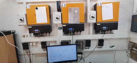

Hello all, first post
I have 3 off 11kw Axpert Voltronic Max E inverters configured in a 3 phase set up with 4 Pylontech US5000 a total of 33kw of panels in 5.5k strings
looking for guidance
I think i experienced this:- When there is leakage to earth from panels (e.g. when raining), this sometimes leads to excessive bus voltage, often leading to shut down due to fault code F08. I don't know if this is purely hardware, or firmware, or both. Some owners have to disconnect their panels at night as a result.
has anyone solved this that we are aware of please?

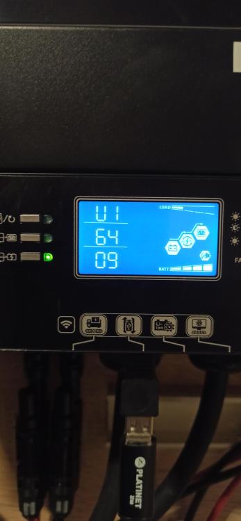

I have an Easun smw 11kw with a removable display. I have 64/09. I tried to upload 64.62 from a USB pendrive. After about 10 minutes, the display returns to the main menu and freezes. nothing can be switched. I have to turn the inverter off and on but the software is still old. what am I doing wrong? Should there be only the "dsp.hex" file on the pendrive? or some other file?
I've never succeeded with that method, but I've not tried hard.
My understanding is that for this model, all you need is the hex file, renamed if necessary to dsp.hex, and it must be in the root directory of the USB stick.
Is it in the root directory?
I assume that's a USB-A to micro-USB adapter between the stick and the inverter?
You end up with the UPD YES on the display and press some key?
BTW,  64.62 is slightly older than 64.09, but it does have the "presumed  good" MPPT logic, unlike 64.09.
There should not be any other files/folders on the root directory of the flash drive other than the update file itself. In your case just make sure that the filename is correct (refer to Coulomb's details). It is known that it might cause a lot of issues when performing a firmware reflash for any kind of equipment. The file readers in these basic equipment are not full fledged file managers, they're so tiny and too simple to handle file management.
