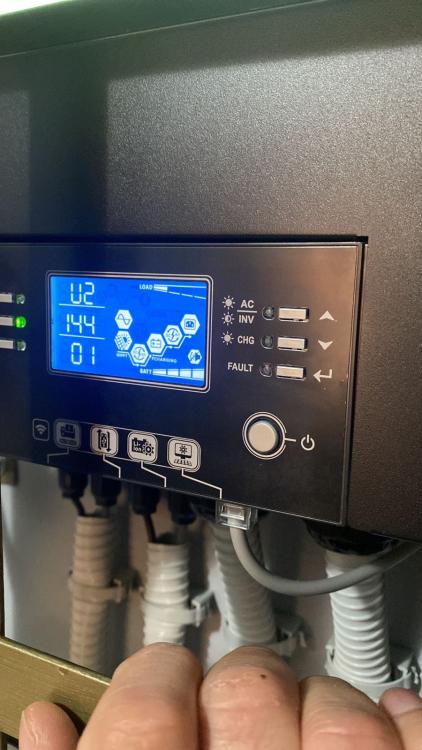

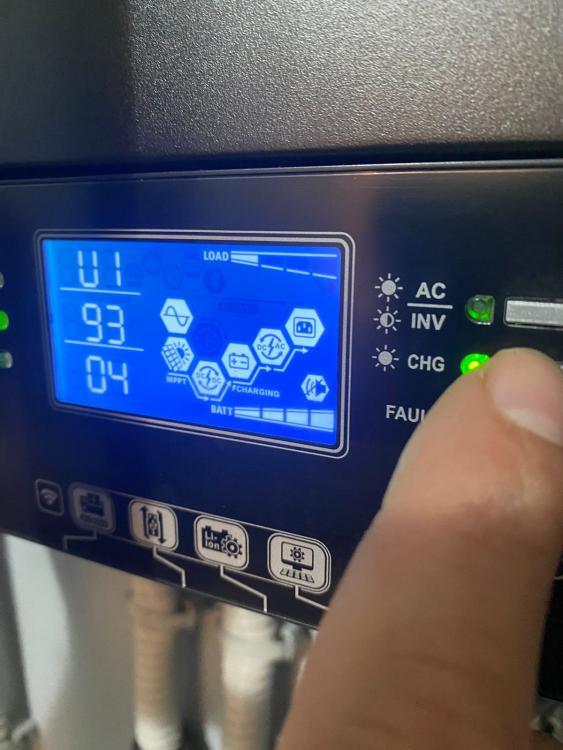

I just happen to have installed this 11k max E unit 3 days ago.
U1 93.04
U2 144.01
Completely different stock firmware and numbers way off. Although, so far very stable other than the typical voltronic known bugs, which on this installation will not likely to be noticed. Unfortunately, i have no means to extract this firmware for the OP.

3 hours ago, mafiose13 said:
U1 93.04
U2 144.01
Well, the 90.xx and 91.xx seem to be experimental versions, so you never know what they are, but maybe 93 is a real major version number.

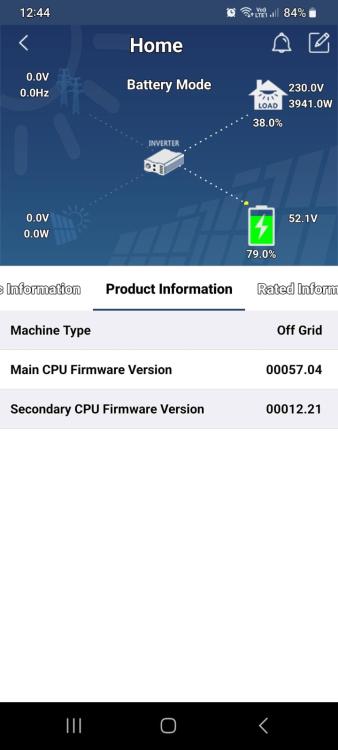

I have the same Axpert MAX E 11kW-48V Off-Grid Inverter which I bought in kit form from powerprovider.
Below is the image from Watchpower.
Is that the firmware you are referring to.
Over and above the firmware, I was wondering how your inverter was performing, mine has only been running for a month or so and all OK so far.
