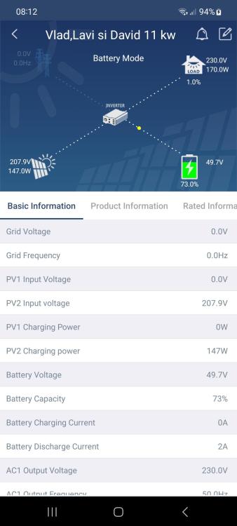

It will be ok if my 2x( 7x405W) pannels works at 200V ? If they go to 190V it will stay in bug ? Because my pannels when i have lets say 3500-4000W in home they can produce 4000W but at 185V. It will be a problem with this ?
Edited by vladsuciu
It will be ok if my 2x( 7x405W) panels works at 200V ? If they go to 190V it will stay in bug ?
This is one of the reasons that I didn't want to put in a specific minimum MPPT voltage, but it seemed that putting in all the patches seems to be best, and I thought surely 200 V would not restrict anyone.
Your panels must be quite unusual for 7S of them to produce maximum power at 190 V (that's an average of 27 V per panel).
My understanding is that you won't "stay stuck", rather the panels will only get "dragged down" to 200 V, instead of all the way down to 90 V. You might still find that this produces more power than you're getting now; your panels might be ending up in a "false maximum" power point due to some shadowing or a similar issue.
But if you find that you end up losing power like this, it's very little trouble (now that everything is set up and worked out) to produce another patched firmware that uses say 150 V minimum MPPT voltage.

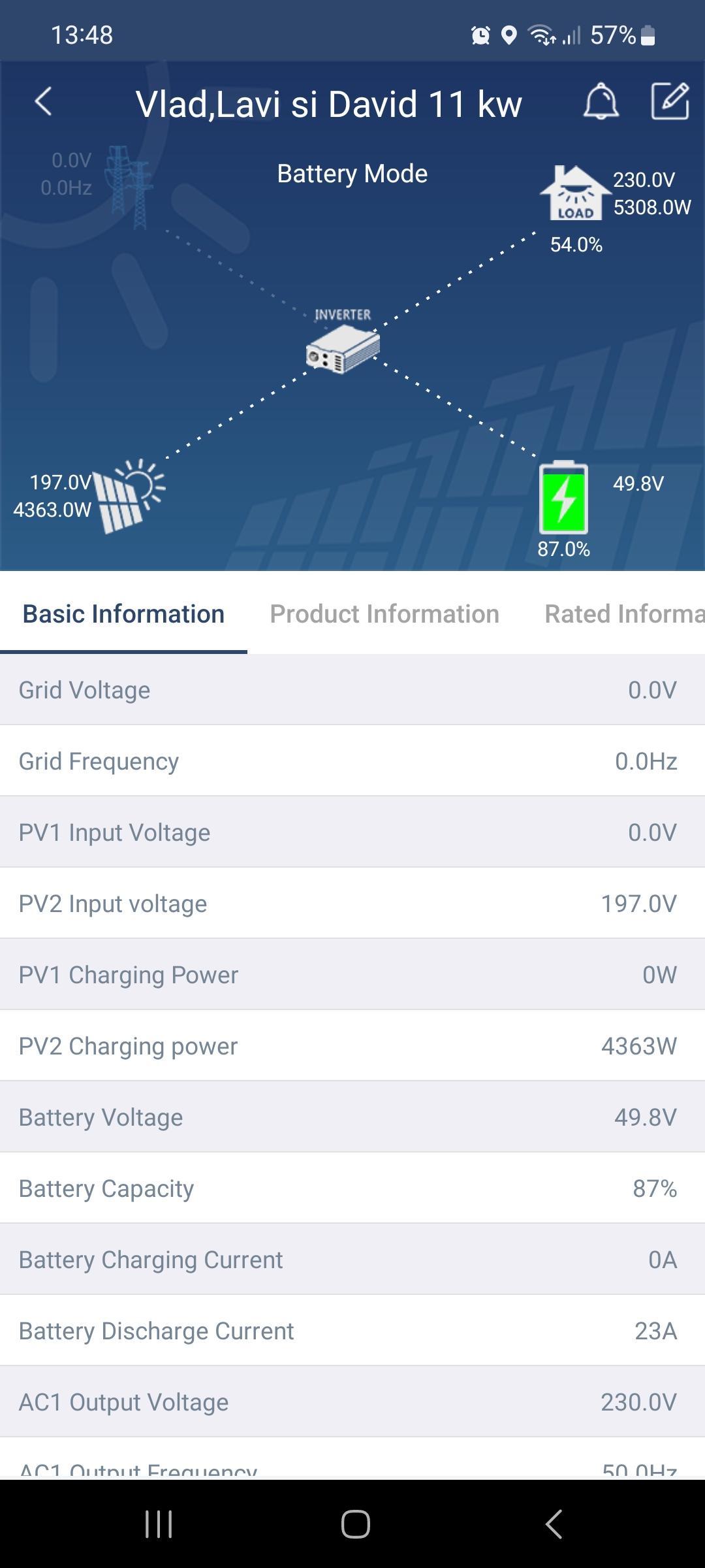

I will put tomorow the 64.62 150V 0.05A new patched. The 64.62 original is not ok for my 230V panels.

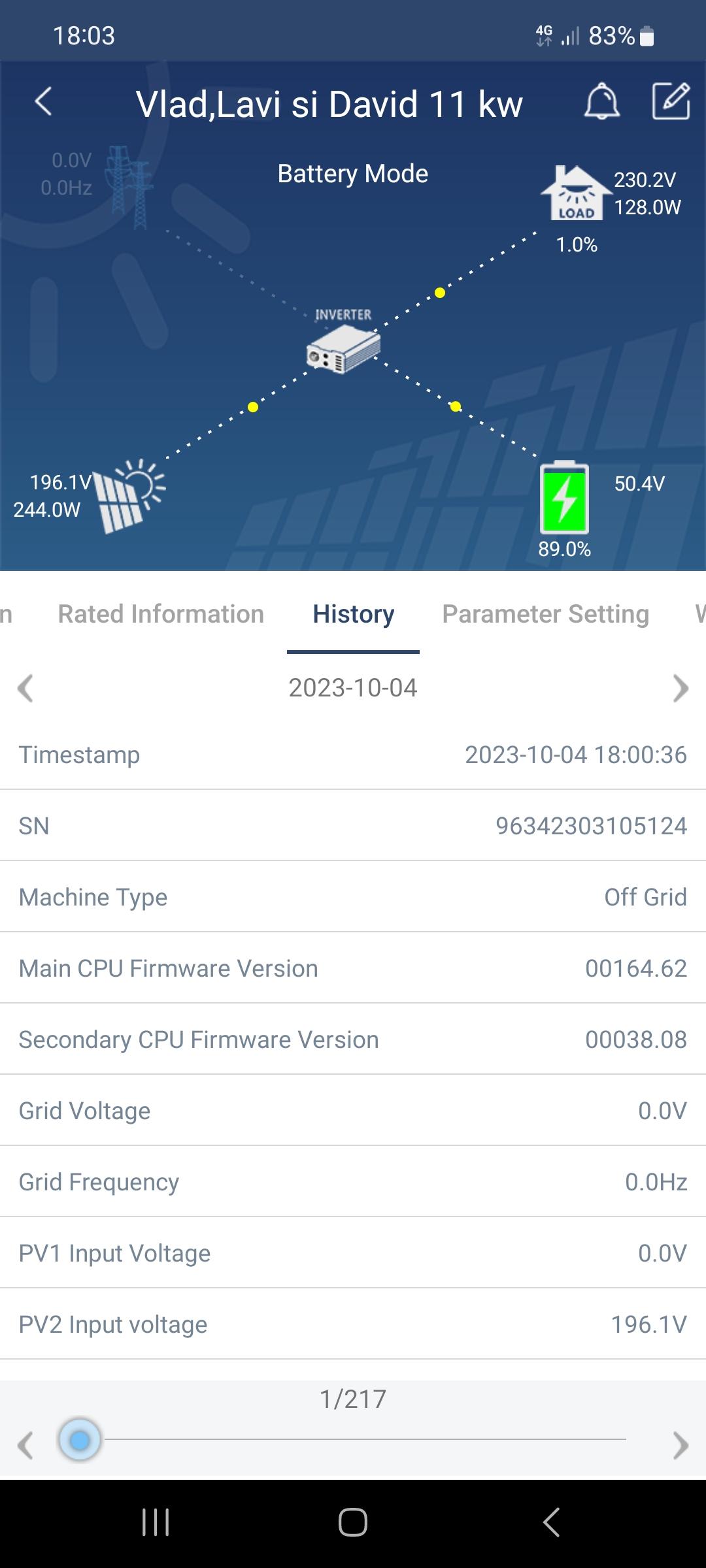

Hi. Now i updgrade my firmware.
I just rar all on desktop and use reflashtool. Everything is ok. Now i see its 164.62 , only on the display of inverter is still 64.62.
Thanks coulomb. All the best for you.
Edit : in the future if i will put on the other mppt pvs who will have 360-380V it will be a problem if i will stay with 164.62?  Ty
Edited by vladsuciu
Thanks @Coulomb . You are the best. This morning the mppt starts with 79V at 7:29 and in 30 minutes my mppt is working in 200V. Your patch is the best. Im very grateful. All the best for you.
