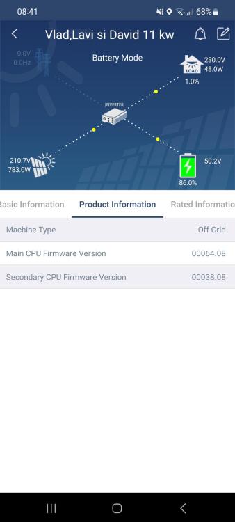

vladsuciu Posted August 12, 2023 Share Posted August 12, 2023 Hi. I have the easun 11kw twin exit. Does this inverter have a new soft for the 90V bug? Quote Link to comment Share on other sites More sharing options...
Coulomb Posted August 12, 2023 Share Posted August 12, 2023 4 hours ago, vladsuciu said: Does this inverter have a new soft for the 90V bug? There isn't at present, but I do have 64.08 firmware, so it's possible if there is sufficient interest. Quote Link to comment Share on other sites More sharing options...

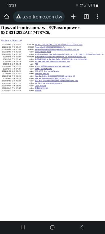

vladsuciu Posted August 12, 2023 Share Posted August 12, 2023 (edited) I have found something on the internet. Do you think its this one good ? http://ftps.voltronic.com.tw/E/Easunpower-93CB312922AC474787C6/ 64.62 Edited August 12, 2023 by vladsuciu Quote Link to comment Share on other sites More sharing options...
Coulomb Posted August 12, 2023 Share Posted August 12, 2023 3 minutes ago, vladsuciu said: I have found something on the internet. Do you think its this one good ? That's one that I monitor; certainly some good firmware updates have come from there. Unfortunately, they tend to often be Infini firmwares, and it's somewhat random as to what Axpert firmwares turn up. Quote Link to comment Share on other sites More sharing options...

Alexyss Posted August 18, 2023 Share Posted August 18, 2023 On 2023/08/12 at 1:33 PM, vladsuciu said: I have found something on the internet. Do you think its this one good ? http://ftps.voltronic.com.tw/E/Easunpower-93CB312922AC474787C6/ 64.62 Nu este buna, te intoarce la versiunea de baza 64/08... Quote Link to comment Share on other sites More sharing options...
Coulomb Posted August 18, 2023 Share Posted August 18, 2023 5 minutes ago, Alexyss said: [ Google Translation: ] It's not good, you go back to the basic version 64/08... In what sense is this not good? Were you able to download it and un-RAR it? Did it not work somehow? Doi you have access to 64.08 or are you looking for that? Quote Link to comment Share on other sites More sharing options...
Alexyss Posted August 18, 2023 Share Posted August 18, 2023 (edited) 12 minutes ago, Coulomb said: In what sense is this not good? Were you able to download it and un-RAR it? Did it not work somehow? Doi you have access to 64.08 or are you looking for that? Yes i tray and i install 64/62, result 64/08.... No, i dont have acces to 64/08 and i dont want this version beacose have 90V bug For the moment i use version 64/61 its OK no bug 90V Edited August 18, 2023 by Alexyss Quote Link to comment Share on other sites More sharing options...

Alexyss Posted August 19, 2023 Share Posted August 19, 2023 (edited) 10 hours ago, add1c7ed55 said: Can u put here this version without 90v bug pls ? I dont have this version, for a few days it was available here (5 mai 2023): http://ftps.voltronic.com.tw/E/Easunpower-93CB312922AC474787C6/ But it was deleted, I didn't keep the file, I just installed the version a few months ago and that's it. when I also made this video: Edited August 19, 2023 by Alexyss Quote Link to comment Share on other sites More sharing options...
Coulomb Posted August 20, 2023 Share Posted August 20, 2023 (edited) On 2023/08/18 at 11:39 PM, Alexyss said: Yes i try and i install 64/62, result 64/08.... Ah, yes, they screwed up the RAR file. The dsp.hex was for the wrong version, presumably 64.08. Fortunately, I was able to perform the final step manually and get the correct 64.62 dsp.hex file. Please let me know if the attached works, and if it works, if it actually fixes the stuck at 90 V bug. It would be great to have a final, official fix. It looks like it would be easy to apply to other firmware versions as well, as a relatively simple patch. [ Edit Oct 2023: It doesn't seem to be the genuine fix we were hoping for. ] 64.62_ISOLAR SMW 11KW TWIN recovered.zip Edited October 14, 2023 by Coulomb vladsuciu and Alexyss 1 1 Quote Link to comment Share on other sites More sharing options...
