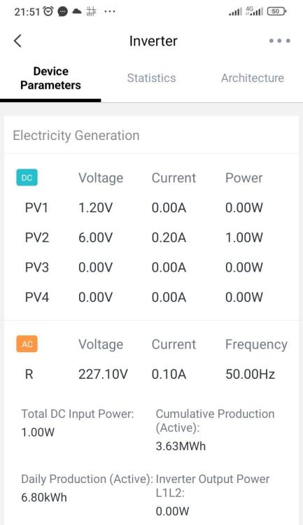

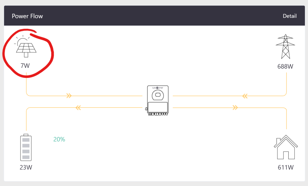

Hello, its 22h56 and my panels are showing 7W of power (String 1 = 2W and String = 5W). Its a overcast and rainy night, no Moon (in case that has an effect). Is it normal for the Panels to produce single digit Watts at night? If not, what is the possible cause/fix? Many thanks in advance!
It's normal for most Inverter to show a few Wats , don't think it's the panels generating any Wats but the inverter showing Wats that's not really there due the a bit a current in the mppt controller components . Some inverters show a few volts as well

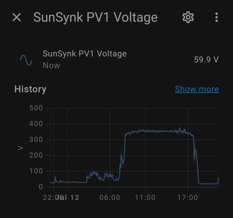

Considering that clouds reflect infrared light, one notices the voltage of the arrays being ever so slightly higher on overcast nights.
My array is 18V on a clear night and around 38V when it is overcast(5W).

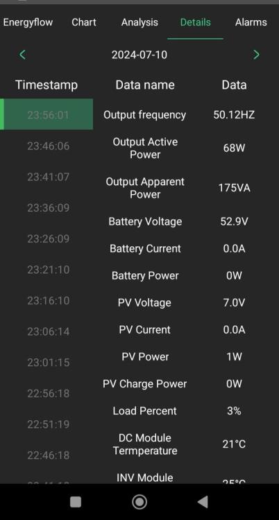

Scorp007 I have seen this with synapse 3+ inverter were it stores all the energy internally for some time after sun set .
Here are 2 inverter of many that I can shear that also show constantly volts through the night

Interesting that there is 200mA flowing. I have tried with a LED torch and you find a voltage say 6V but when adding even a 30mA load it just collapses.

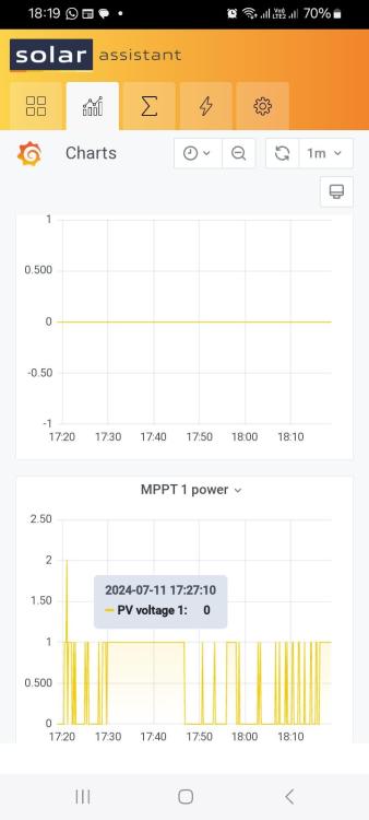

I have also seen on cloudy evening the sky seems to contain more light than when there is no clouds.
I normally disconnect my panels when testing the voltage so inverter has no affect.

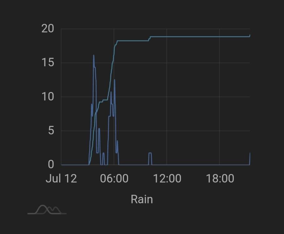

If I look at my weather station data and the pv voltage it nicely correlates with when the rain comes pouring down.
I've attached a graph that breaks down solar radiation and it shows waters willingness to absorb infrared.
