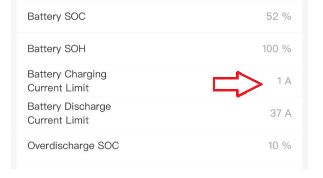

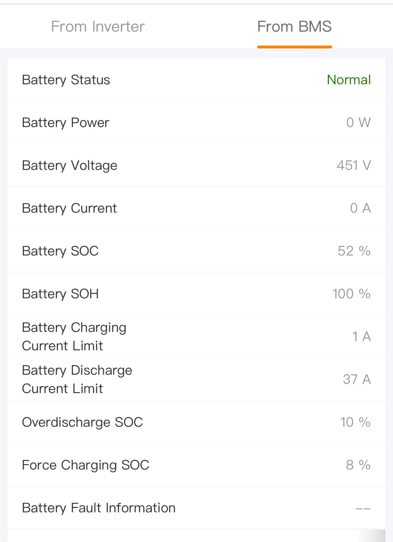

Hi Greenfields this is what i get to see. I will try to acquire the rest of the info (capacity) and if possible set the values and see how it works then. ThanksIMG_0844.thumb.jpeg.7a87d81a99d0a171c4e19043b7504acc.jpeg

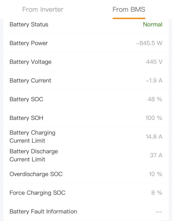

10 minutes ago, Tinbum said:
Think you need to alter this.
Hi Tinbum, it’s 14.8 now. I don’t know why it changes the value when i make a screenshot
Did you balance the batteries before fitting?
As they are in series as soon as a single battery gets to 100% SOC it will stop any current flowing through the others. (Unless Pylontech have a way of overcoming this internally).
Ah, that's because the BMS is limiting it. In your first shot the battery is at 52% which is when you say it reaches its max SOC.
I'm pretty sure your problem is because you fitted the new batteries when they were at 52% SOC (or perhaps say 30% and SOC is average), as supplied by Pylontech and the older ones were 100% SOC ie fully charged. (Edit probably the opposite way round as the manual says they come at 100% soc unless otherwise requested by supplier.)

I'm sure it's because the new ones were fitted at a vastly different soc as I said above. They probably will balance, as shown by the 1A setting but it will take weeks / months.
Edit The new batteries need removing then the old batteries discharging to the same soc as the new ones and then the new ones adding in again. Their may be other ways depending on what you have available.

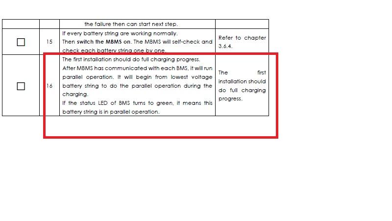

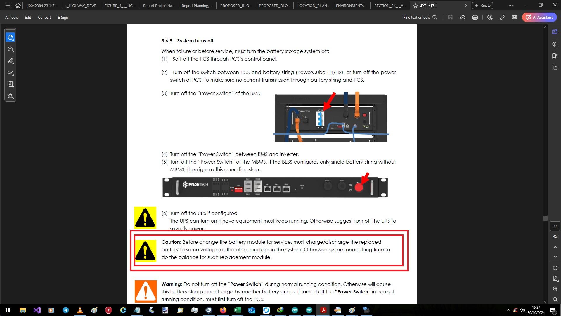

Just had a quick glance at the manual and it shows a warning here and says pretty well what I thought.
and
It also explains here how the system works. A reinstall as a first install system would have sorted it but making sure that other conditions above are met first to ensure no high surge currents that could damage things. this is for multiple strings though.
