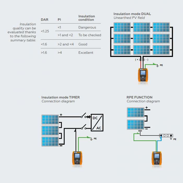

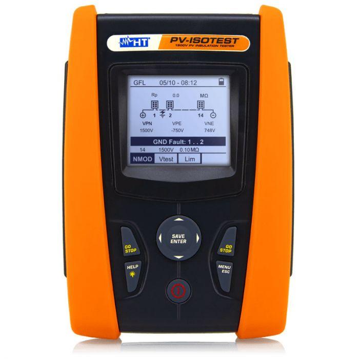

Could a regular electrician make some measurements to diagnose and solve the issue if one of you provides directions, or should I call a solar expert.
Yes a electrician could do an insulation resistance test on the solar system using a normal Megger tester and provide you with an solution. This method will take time as individual solar panels needs to be tested isolated from the solar wires and mc4 connectors. Should all the panels pass the IR(>2MΩ, test, then all the wiring needs to be tested.
A solar expert with a string maintenance tester could pin point your problem within a short period of time with 1 test and all components intact. My company have invested in this tester very very expensive but worth while in the long run. Maybe you can enquire of such a solar expert with a string maintenance tester. Below picture of the tester and connection diagram as how it pin points the fault.
