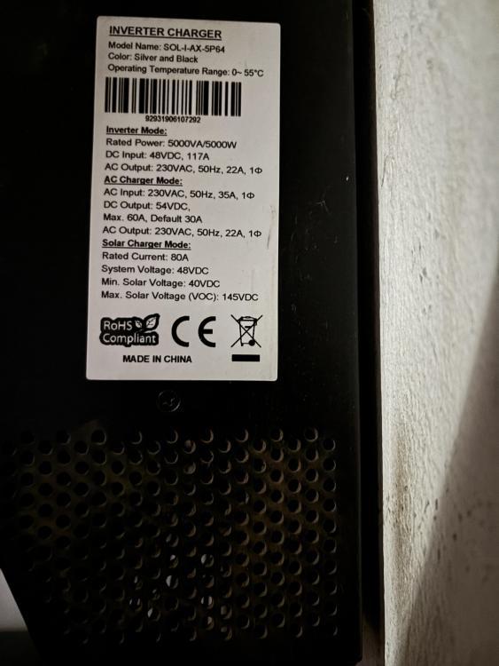

Hi yes, this data is basically from what i have seen from observations of the inverter and charging cycles. I am not sure how to get the data from the inverter to show usage. Maybe if you would like better insight you can guide me on how to do that? We are running a 5 kva mercer inverter. Purchased in 2019
model number: SOL-I-AX-5P64

5 kva mercer inverter. model number: SOL-I-AX-5P64
I am not an expert with those inverters. Am tagging @Coulomb to maybe chime in with his endless knowledge
It seems that your inverter has 145V max VOC on the MPPT, so we would need to know how your panels are wired (e.g., 3 in series and that 3 times in parallel - 3S3P)

@wolfandy you're right the max VoC is 145DC as per the sticker sent.

99.9% of recent installations would be for high PV voltage. My guess is that the installer assumed the usual 90-450 V MPPT range, which isn't going to work with this inverter.
Quite possibly the solar charger has been damaged if this is the case.
I'm a little surprised that this inverter was made as recently as mid 2019.

My take is your Panels don’t seem to be enough for your setup but unfortunately limitations on your inverter max VoC (145)may limit how many more panels you can add meaning you may have to get a different inverter which allows you to put more panels.
