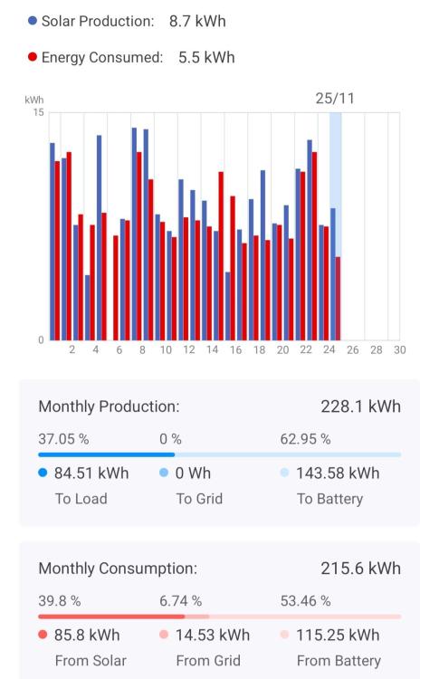

November 25, 2025Nov 25 20 minutes ago, Denns said:Believe it or not, I actually averaged about 900kWh a month before getting solar. With solar, not counting the geyser, I use about 200 to 250kWh a month (Monthly PV generation for this month is about 900kWh). Geyser when I had it on the grid was about 200kWh a month so in total now about 450kWh. Halved my consumption!As for the savings, its true it does look nice on a spreadsheet to have big savings by inflating the costs but I accepted it. Same way I accepted that 2/3 of my solar generation is wasted every day. But it saves me when the rain and clouds start.Here is my consumption for the month. In my area this month has been very poor, lots of cloudy and rainy days. it's been the lowest production since installation 4 years ago.Here is my dashboard for this month.Previous month.

November 25, 2025Nov 25 @Denns You don't waste a single watt 😃The lowest i can get my load is ±750w- Alarm, Cctv & Monitors chew about 500w rest is for fridge & freezer. All my lights is on separate system. So ya - i will never get to your figures!

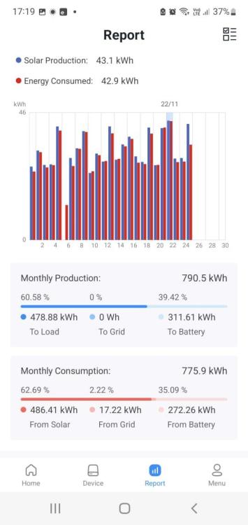

November 25, 2025Nov 25 My Nov figures, sun is good this month. Edited November 25, 2025Nov 25 by Demo Wrong Pic
November 25, 2025Nov 25 19 minutes ago, Demo said:My Nov figures, sun is good this month.I see a major difference between us. Apart from size I use 53% of my consumption from battery. Few loads on during the day. Can only increase my loads from PV during weekends. This month had at least 10 not so good days due to cloud. We both share the positive that we get more from PV than what our consumption is.

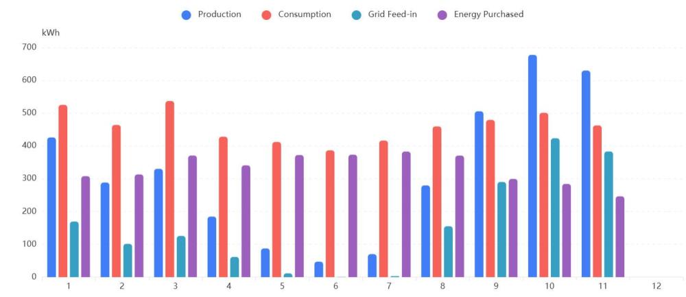

November 26, 2025Nov 26 Author Here's why I need more batteries....Installed the 4 x 600w JA panels middle of September, now I'm generating way more power and pushing back to Eskom more than I'm consuming :eek:Its time to go off grid.... Dont want to be involved in "feeding" that corrupt SOE.PS: the bad dip in generation on month 4 to 7 was due to tree's shading my panels, I built a new roof higher up to compensate for the shading and got immediate returns as you can see in month 8 Id love to stay with Volta batteries, however I cant take the chance that they change the BMS again in the next 4 years and screw up my upgrade plans again... Edited November 26, 2025Nov 26 by SulacoMcClaw

November 27, 2025Nov 27 @SulacoMcClaw ,Agreed, you need to start seriously cycling your batteries.Looking at your monthly graphs, I could not understand why you are consuming vast quantities of grid (which you have to pay for).Lucky that the grid feed-in compensates somewhat, but in my book, grid usage should be very close to Zero. When I saw you daily consumption graph, it all made sense, you are (hopefully by now - where) using grid during the nights.Fix that setting, and smile all the way, and hopefully you batteries are not compromised by the "keep it at 100%" scenario you had. Keep a lookout what your SOH is doing.4 years and 830 hard cycles my SOH is still 100% on both batteries.I ran my batteries down to 20% daily for years, while we could feed-in, and since feed-in tariff changes, it doesn't pay anymore, so the daily cycle is down to 50% on normal sunny days, with the occasional 20% during more cloudy days.
