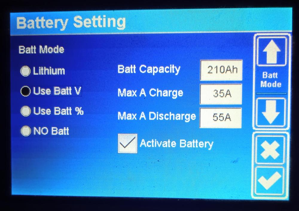

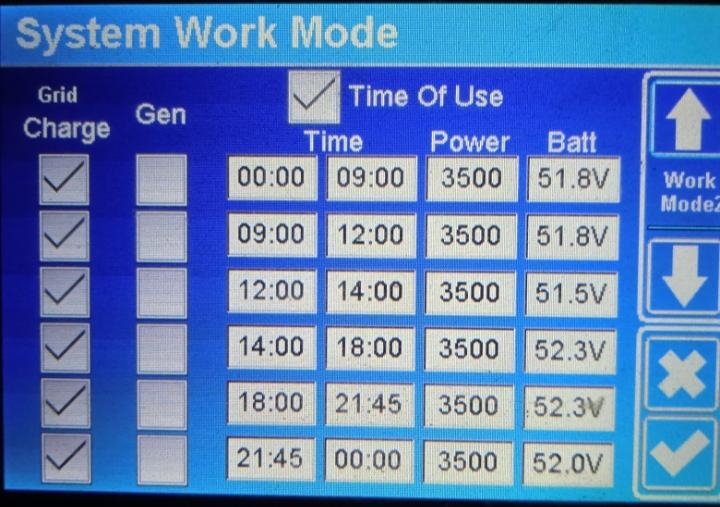

14 hours ago, SulacoMcClaw said:
The change to voltage control is real quick. Ensure the battery values are filled in under battery setting.
The decide on levels to use grid under the system menu and press the down arrow. Then tick the right arrow after setting and then out of the menus

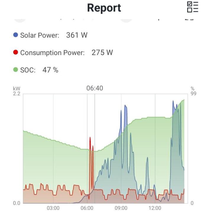

Your night-load must be next to nothing to only use about 40% of that lead acids? If i remember correctly you mentioned in a different thread that your overnight load is ±40% ?
You are a brave man to trust that lead acids!
In the year I have had them, the lowest they have dropped to is bout 65% SOC. This was after almost 4 days of rain. Almost every morning, I sit at around 80% SOC, so I'm only draining about 20%. For my battery bank, it's about 2.5kWh. You are right, I don't use much at night. Most of the loads are run during the day. The house averages about 8kWh a day, excluding the geyser. The geyser is on a geyser controller.
I have a very efficient house, which took a bit of work to get it to that point. It was way cheaper to do that than to build a humongous battery bank. Dishwasher, washing machine, pool, and fish pond pumps run during the day. With TV, laptops and gaming PC off, my baseload is only 70W at night.
I trust the batteries lol. They run the microwave, kettle, etc, just fine at night. Haven't noticed a drop in capacity yet in the year I have had them. They already paid for themselves with the savings, so whenever their capacity drops, I will have enough money for Lithium, but based on the 20% discharge I do every night, I will easily get to 5 years of use according to the DOD vs cycle life (should get around 2500 cycles), so I still have another 3 to 4 years left.
It's just a case of understanding the battery chemistry, which most people don't bother learning. I have a 125A DC breaker, which limits the current for each parallel battery string to 25A, so I can never pull more than the recommended amps from each battery (I can go as high as 3kW at any instant). I have battery balancers. And I sized the bank to cater for 20% DOD usage at night, not the 50% as that would only give you some 2 years of capacity.
My array also generates 3x what the house needs on a daily basis. With the pool pumps off, 5 times more. So when the clouds hit, I only need 20% of the generation to meet my load.
