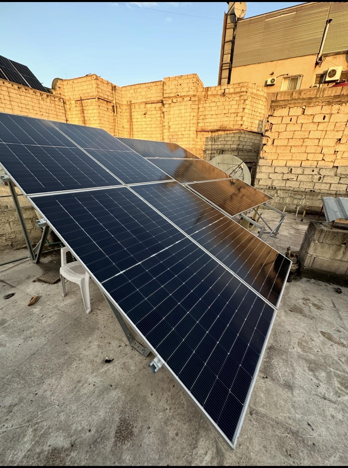

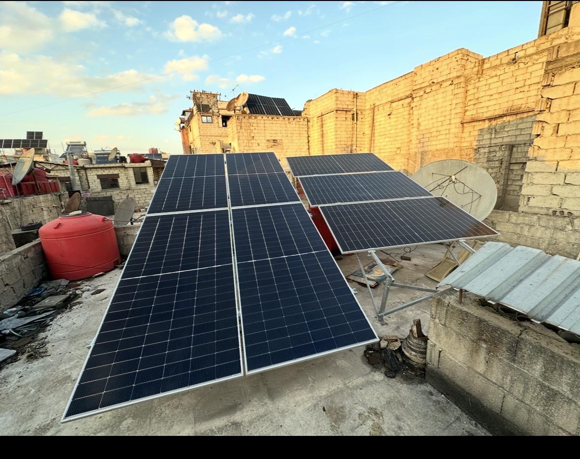

I have a rooftop that is not small, but it is surrounded by walls. There is a slightly higher building on the left side and a very tall building on the eastern side that deleys the sun rise till 08:40 in summer and 09:30 in winter . Because of this, my roof is heavily affected by shading.
This situation left me with only a small area where I could install four solar panels that are not affected by shade from 9 a.m. until 4 p.m.
Recently, I had to add three more panels. However, sunlight reaches these new panels one to two hours later in the morning compared to the original four panels. In the evening, sunlight disappears from the old panels while it is still available on the new ones.
I assumed that the bypass diodes would handle this issue by isolating the shaded panels so they would not affect the illuminated ones. However, it seems that this does not happen in reality: the shaded panels limit the performance of the illuminated ones and pull their output down. Maybe my inverter doesn’t do global sweep/scan
I considered connecting the three new panels to a separate MPPT input, but I am concerned that I would lose the advantage of higher voltage achieved by connecting the panels in series. In other words, the performance gain I might achieve in the early morning could be lost during peak production hours.

@esmail-kassir I'm a bit confused - could you please clarify: Is east to the right in the photo above? If so, then are your panels not facing south - I do note that all the other panels visible in the photo are also facing the same direction, so I'm probably understanding this wrong...
Regardless, would it not be possible to move your panels further to the left (of the photo above), and have the highest part of the panels cover the red (water?) tank visible in this photo? Obviously if east is to the left then the panels are facing north, and moving the panels closer to the high building would not be an option as that area would be covered more by shade.

I think this pic was taken in Northern Hemisphere?
you are correct , It is in Damascus Syria
Once you have two strings you don't have to have them physically adjacent to each other. You could have two arrays, positioned to take advantage of different light and shade on your roof space.

OK, thanks - that clarify matters 🙂
So, why can you not move your first string of panels further west, with the highest panel being over the red water tank as I previously suggested? You could even let the panels overhang (cantilever) some distance (one panel width...) over the western wall to make room for the second string to be placed further away from the eastern wall, thus reducing the effect of the shadow of the high eastern building to some extent.
