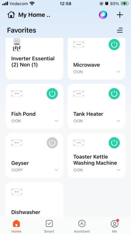

I dont use HA personally so havent had the issues with lag and unresponsiveness. I have quite a few devices at the moment and almost every plug in the kitchen has a Tuya smart switch. I use smart life to create the logic for when what comes on etc. Because I have a small inverter (3.6kW) and am off-grid, when a kettle is on for example and some extra stuff to the point where the power exceeds 2500W, the app automatically switches off the other high power devices until the power drops back to below 1000W. Almost elminates any possibility of overloading the inverter and having to reset it.
There is a whole bunch of stuff one can do with the app and the switches are the size of a gate remote rated for 16A so pretty good in my opinion. I plan on expanding it to add the pool which has a non wifi based timer. Lights are all automated outside but they are motion sensor based and have no need to use a smart switch for that. They are around 25W with the smallest being 18W and pick up any movement within 15 meters so if there isnt anyone walking outside it is pitch dark bar the occasional cat. They have a remote so if I want to turn them on manually I can do it from the comfort of my house.
Energy monitoring is done by the app also. I have no dongle on the inverter and dont plan on buying one. So I use a CT based energy monitor (2 gang) that measures the kitchen and the rest of the house. Each smart switch has energy monitoring also so I get plenty of information.
I dont particularly care about PV generation as in the 10 months I have had solar the batteries are always charged and wont be buying a generator to supplement power. Not bad considering I use GEL batteries.
