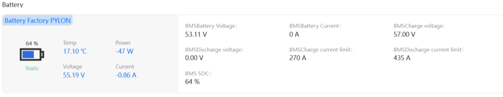

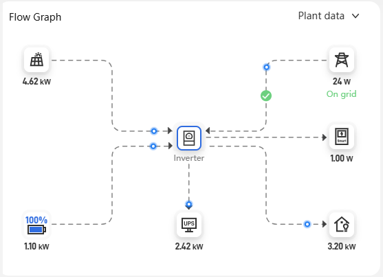

The battery has been on 64% all day. It was on 65% just prior to the solar taking over the house load. The installer updated the firmware as well earlier on but no change. The moment turn on the pool pump the solar generation increases to match the load but no excess solar are going to the batteries.
Also, I enabled grid charge and turned off time of use. The batteries aren't charging from the grid either. This worked fine a day ago with the storms.

Thank you very much. I will give this a go when I get home.
1 hour ago, Stefan Cornelissen said:
I find this really weird. 64% @ 55.19V with almost 1 amp going out. Something does not add up
The BMSbattery current limit to 0 might be stopping the inverter charging

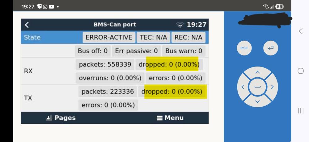

Yes I agree the 55.2v = 100% Soc. @jdido87 i will get the installer involved to get the batteries tested by the supplier. Insist on getting al 3 modules tested in parallel with communication enabled to ensure data packages are not dropped.
Example of a healthy CAN network communication from a Victron System.
