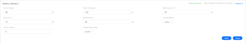

Thus far it is doing exactly what I want but I do think I am missing some performance. I will gladly take some advise on the settings below.

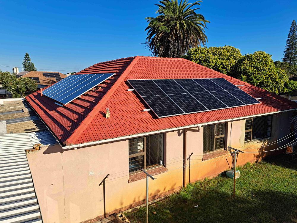

Off the cuff, I'm a bit concerned about that tree shade on the western end of your roof - I suspect that it will move over a part of your westernmost panels (and this could get worse in winter when the sun is lower...), and that could restrict your midday to evening solar yield. Watch it for now, and if it does become a problem then consider cutting down that tree - owners of solar systems invariably (and rapidly) also become owners of chain saws 😆
This picture was taken after 5pm. The is my guava tree that needs to be pruned but by the time when those shadows come on to the roof the sun is very low already. I will prune that tree soon otherwise my roof and gutters gets filled with guavas.
No problem then... Just watch it as the winter approaches.

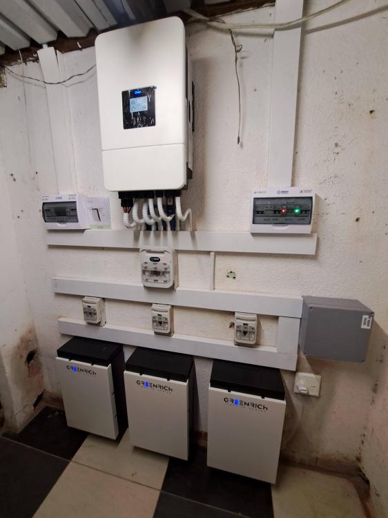

16 hours ago, Denns said:
I am wondering about that inverter. It is right under the corrugated roofing. I don't know how long it will last staying mounted there as heat will kill it very quickly. It gets insanely hot under metal roofs.
The eave of the house is over that particular section but I am going to insulate it and fit rhinoboard as soon as I am done with some other things in that room. It was my laundry room, poolpump house and toolshed. The washing machines and poolpump was removed. I will be installing a window in one of the walls as well just to control temperatures inside there. The windows has been delivered already and it will be installed over the long weekend
Or you could install a small inverter type air conditioner - this has the dual advantages of both keeping your inverer and batteries cool in summer, and warm in winter if required, and also use up some wasted spare power generated by your system in summer - assuming that you designed your system with adequate winter production in mind... Aircons are relatively cheap, and extending your expensive batteries' life by a year or two by keeping their temperatures within the "Goldilocks zone" would probably fully cover this additional cost.
If I were you, I would also add a false ceiling with some Think Pink thermal insulation between this ceiling and the roof.
The room has no direct sunlight and stays relatively cool most of the time. I am doing double insulation with a layer of sisalation and isotherm. It worked a charm in my brain room. I just need to sort out the ventilation. Started with the window opening today. I will have to tint that window as that wall is hit by direct sunlight for the most of the day. I am going to mount an extractor fan in the door that can run permanently during the day.

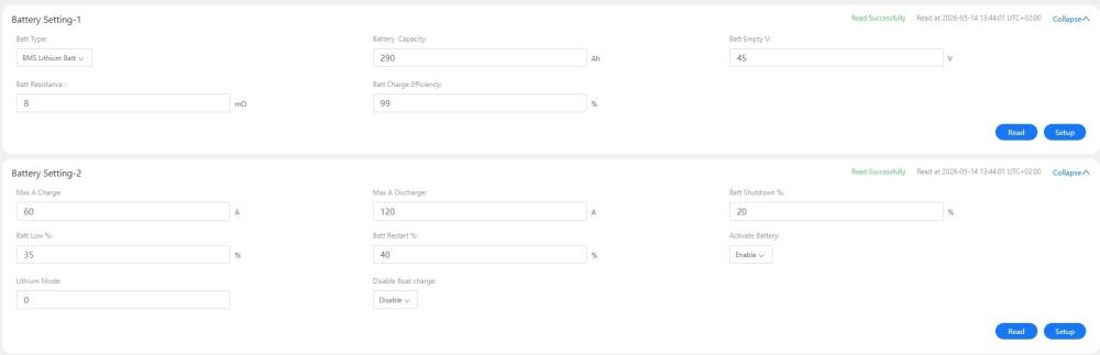

I need some advice.
My discharge rate is set at 120amp. Is this too high?

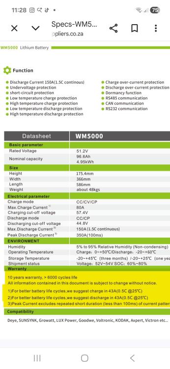

You are spot on at 120A if you read the warrenty clause on the OEM spesifications. 43A x 3 = 129A charge discharge for the 3 batteries in parallel. See bottom section of spec sheet highlighted in yellow.
@TaliaB They specify max continuous discharge current at 150A, surely this 0.5C is just a suggestion to get more than 6000 cycles out of the battery? If you had to set max discharge on the inverter at 180A thats only 60A on each battery. Just the way i interpret it🤷‍♂️
I agree with you no problem discharging at 0.5C but if the op doesn't need it to be set higher than 120A as the installer set it up then it is fine why change it. If the load depicts higher draw from the batteries there is ample capacity.
2 hours ago, jdido87 said:
I need some advice.
I was merely responding to the op's question and referenced the spesification sheet.
0.5C is good for extended battery life, as @TaliaB and @Scorp007 confirmed - just be aware that the manufacturer's warranty also state "@ 25 degrees Celsius"...
Inverters generate a lot of heat, and batteries also heat up when charging. It was mentioned earlier in this thread by @Denns that the "inverter room" being quite small, and with an IBR (metal) roof with no ceiling could become hot. The response from @jdido87 did confirm that insulation would be installed, and that this would (obviously) keep external heat out... but the same insulation would tend to keep internal heat in... Just something else to keep in mind...

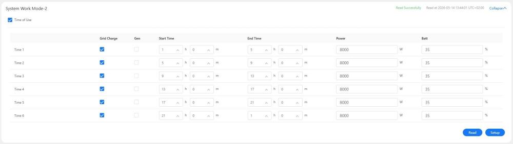

I seem to have an issue. It is a beautifal sunny day in Cape Town but I am only generate 338w. If I turn on a pump then the pv generation spikes. With the storms we had recently I changed the quick settings in the Deye Cloud app to force charge mode so that the batteries could charge from the grid. I have since changed it to self consumption mode as I cannot seem to disable them from the app. I also disable grid charge and enable time of use again.
Any idea what can cause the low pv generation? No shadows at all being cast over the panels.
I notice that the inverter is not prioritizing charging the batteries.

It seems the inverter is only powering the house load.
with regards to the system not prioritising charging the batteries, under system work mode 1 ensure that the energy pattern is set to "Batt First". Would be beneficial to post a screenshot of your system work mode's setttings.
See attached screenshots of the settings. The workmode is set to Batt First.

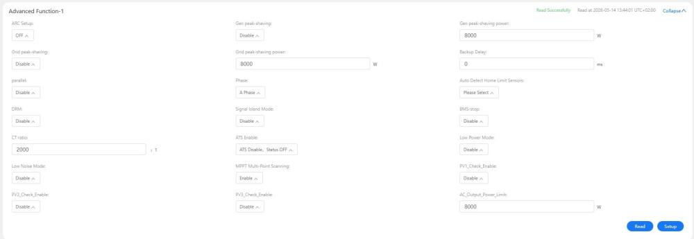

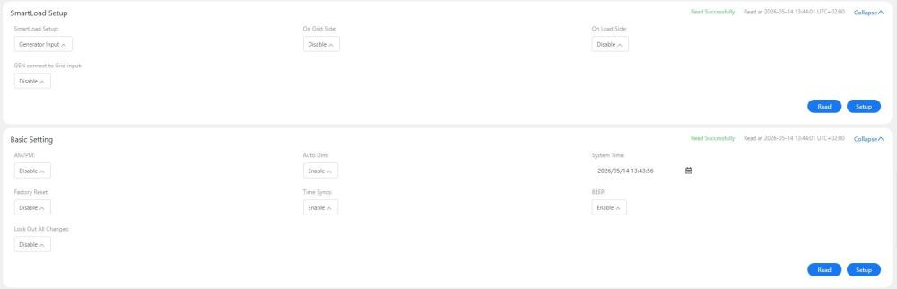

that is super strange, everything seems to be in order. what are your batteries currently at? you may aswell enable grid charge (your TOU has ensured as minimal grid usage as possible). Try disabling your "MPPT Multi-point Scanning" setting as you mention you don't get affected by shading. if this doesnt work, try turning your PV off and waiting until there is no voltage for pv on your inverter screen and then turn it back on.
The battery has been on 64% all day. It was on 65% just prior to the solar taking over the house load. The installer updated the firmware as well earlier on but no change. The moment turn on the pool pump the solar generation increases to match the load but no excess solar are going to the batteries.
Also, I enabled grid charge and turned off time of use. The batteries aren't charging from the grid either. This worked fine a day ago with the storms.
Edited by jdido87
