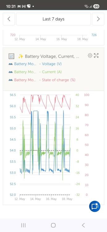

May 18May 18 Author 29 minutes ago, Scorp007 said:As you are indicating something is wrong. Your SOC for a 40kwh battery cannot go from 51 to 100% in 12 min if you only have 2200W from the panels.Are you using comms for charging control as it appears the case with the solar charging current in the table showing volts that were rising.Also the sudden increase to 100% in your graph and no charging while you had enough load connected for the time after 13h06 while the battery did discharge.What does your graph show for 17 May?Thank you for your feedback. I will revert.
May 18May 18 52 minutes ago, SRTosen said:Thank you for your feedback. I will revert.On VRM portal create a Widget to show you battery SOC vs Battery current vs Battery voltage. Also ensure your bms is communicating with the system. Then on VRM check under Battery details for the highest and lowest cell voltage.

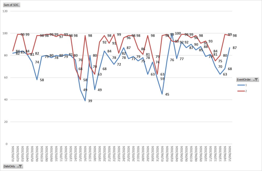

Sunday at 11:462 days Author 30 minutes ago, esmail-kassir said:so is it solved ?So far yes. I have not seen a spike in the charging from solar since. At the same time, the SOC has not dropped to 51% since the initial event.It subjectively appears that the battery appears to be perfoming better - the yard stick being the SOC when the MPPT switches of and then when it switches the following morning. There are many variables overnight. This also does not exclude lifestyle changes to try and ensure that when the MPPT switches of, the SOC is 100%. I am comfortable with an 80% SOC at about 06:00.Pre‑firmware (01/05/2026 → 01/06/2026, 32 days)Avg SOC at First (morning): 72.8%Avg SOC at Last (evening): 89.0%Post‑firmware (02/06/2026 → 16/06/2026, 15 days)Avg SOC at First (morning): 82.0%Avg SOC at Last (evening): 92.0%Delta (Post − Pre):Morning SOC: +9.2 percentage pointsEvening SOC: +3.0 percentage pointsThe chart below does not contain enough data yet. The blue line is when the MPPT is "Active" and red is Off.
