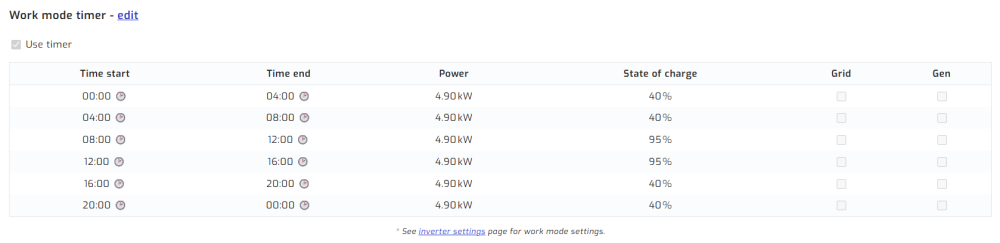

Any reason you don't drain lower than 40%? Most lipo batteries these days have discharge depth down to like 10%.
Your power values for all time slots are max for your inverter. My use case is a little different. At night after dinner all the way to 6am, my house base load is about 1kw or less. But as it's winter and I have someone that is ill in the house, I keep an aircon on through the night, what I was trying to do is set the power value to 1kw, to let the battery supply the base load, but when the aircon comes in, the grid can supply it. This is my use base for wanting to split the supply between battery/grid.
2 hours ago, H1771 said:
So, there is no real reason for 40% other than the installer was happy that that value should be fine for our usage. And those power settings have worked fine for us.
TBH, have not done much tinkering with the system since installation as all has worked fine for our usage.
MdF
