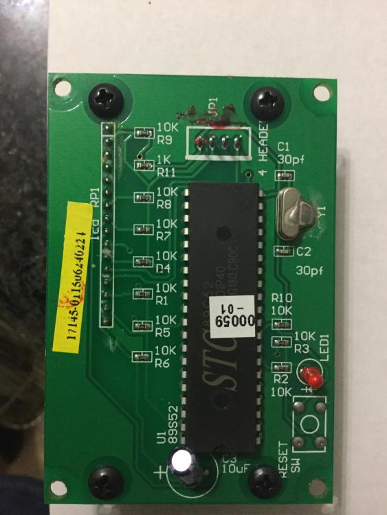

July 3, 20197 yr Does anyone know where I can get a new LCD display for a Devel 6000w inverter? There are two lines missing that make it difficult to read.
July 3, 20197 yr That's almost certainly a stock standard Hitachi HD44780 16x2 LCD. You can get them just about anywhere. And they are cheap enough that if you get it wrong it's not too bad. Edited July 3, 20197 yr by plonkster
July 4, 20197 yr Mmmmh, I am wrong in this case. It looks like a Hitachi HD44780, but that chip on the back is an 82C59 microcontroller. So that board is more than just an LCD. But maybe you can solder parts of a hobbyist board onto this one. You only need to replace the LCD after all.
July 4, 20197 yr 9 minutes ago, plonkster said: It looks like a Hitachi HD44780, but that chip on the back is an 82C59 microcontroller. I agree with Plonkster here, just get the LCD board from one of the loaca shops, and replace the LCD and board. That 16 pin connector is standard on those LCD's
July 4, 20197 yr Man... O should learn to look properly. This is two boards stacked on top of each other. The bottom one has an Atmel MCU (as already noted), but the top one is very likely still the stock-standard LCD I mentioned. You should be able to desolder the 16 pins (some desoldering wick or a desoldering pump is helpful), then simply slot the new one in. The one I linked above has an RGB backlight, ie it's similar but not exactly the same. You may have to shop around a bit to get one that is pin for pin compatible. FWIW, the LCD used in the new EasySolar-II inverter is the same, as is the one in the Microcare MPPTs 🙂
July 4, 20197 yr 51 minutes ago, plonkster said: Man... O should learn to look properly. Playing "Flip-Flop" today. This is the standard one available at R90, and again in Green, Blue (like the inverter one) or white, (I prefer)
October 15, 20196 yr Author I found a local shop that sells these LCD screens. However they want to know from me if it is a 5V or 3.3V LCD. Is there a way to tell without separating the boards?
