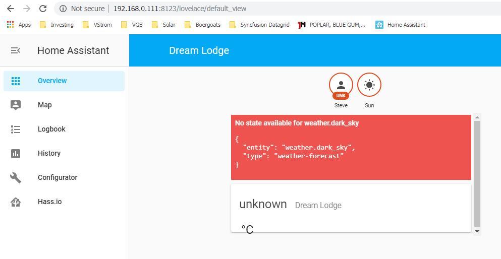

I am still stuck at the point of getting the Pi to connect to the internet. very annoying, it initially worked, but now not. I have the pi plugged into a wired network on a fixed IP address, and I can see the HA app from either the wired or wireless AP. It seems there is a problem with DNS as the pi can't find anything on the internet, so that default installed weather service cannot be connected to. But if I install a component from the internet, then it is found and installed.
So I get this:
The log file shows :
Tue Jul 30 2019 12:17:04 GMT+0200 (South Africa Standard Time)
https://aa015h6buqvih86i1.api.met.no/weatherapi/locationforecast/1.9/ returned Cannot connect to host aa015h6buqvih86i1.api.met.no:443 ssl:None [Try again]
And similar for anything else it has to find on the internet.
Any ideas anyone?

But still none of the entities are able to connect to the internet, I still get errors like this:
