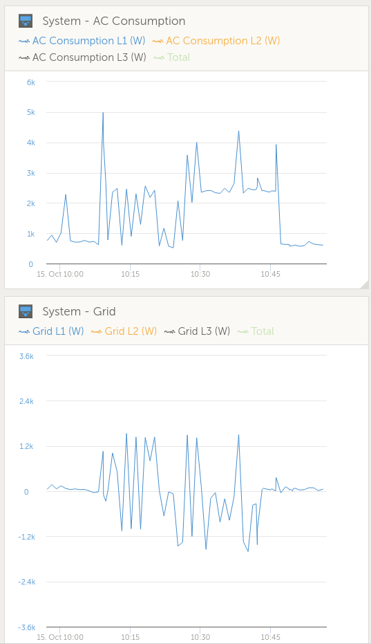

New issue: Clothes iron is driving me mad!  It has an bimetal strip temp control - 11 seconds on (1500W) , 11 seconds off.
It takes about 6 seconds for the 112ET meter -> Multiplus II feedback loop to settle on the grid setpoint.  The kwh used for that 6 seconds is about 25% of the total cycle time, which means we pay COJ for using the first 25% when the iron switches on, and another 25% when the iron switches off (and we are sending that power back to the grid) - that adds up to about half of the iron's normal energy cost. It happens much faster than can be seen on the graph that just samples every minute, but you still get a good idea:
563704655_Screenshotfrom2019-10-1510-57-16.thumb.png.a0708c361d0d2930b54027a218f6ed24.png
Help me think of a solution - is there a light switch dimmer that will work if I put it in line with the iron?  Let's say I set the dimmer to 50% - the Iron will just heat up to 50%, and the bimetal strip will be always on...?  The light dimmers use a switching mechanism which kind of distorts the AC waveform because it can be leading edge or trailing edge dimmers.
EG for a trailing edge dimmer - the triac will switch on at the AC zero crossing, and switch off at max voltage (for 50% power).  This means every cycle will see a lot more current on every leading edge of the AV waveform.  Will the Victron MPII be ok with that? @plonkster ?

I suppose it depends on how close you are to 100% self consumption. Since I'm nowhere near that (closer to around 45%) I simply don't care about those small amounts taken from the grid, all I care about is that I use as much as possible of the PV, in other words, the balancing act for me is making sure the batteries don't get full prematurely (but that they do get full every few days). I'm going to buy half my electricity from the grid anyway... who cares that a small portion of that is while ironing.
I don't know about dimmer switches. I've used a heat gun on the test bench Multi, and I'm told that at half-power those things use a diode to cut half the waveform. That is technically one of the worst things you can do to your AC waveform... and it seems fine.
Edited by plonkster

Feedback on the clothes iron - dimmer.  The iron' bi-metal temperature regulator still switches off - every time when you put the iron down and there is nothing cooling the plate.  So the waveform still look horrible, but with a smaller altitude.
The ESS system still sends spikes through to the council, but they are about 800W, where they were 1600W before the dimmer.
The spikes look more random.  I had a look at the ET112 readings while the dimmer was used and it looked like the dimmer "confused" the ET112 - the watts reading jumped around a lot - and thus the poor MPII had to try to increase or decrease power output continuously.
