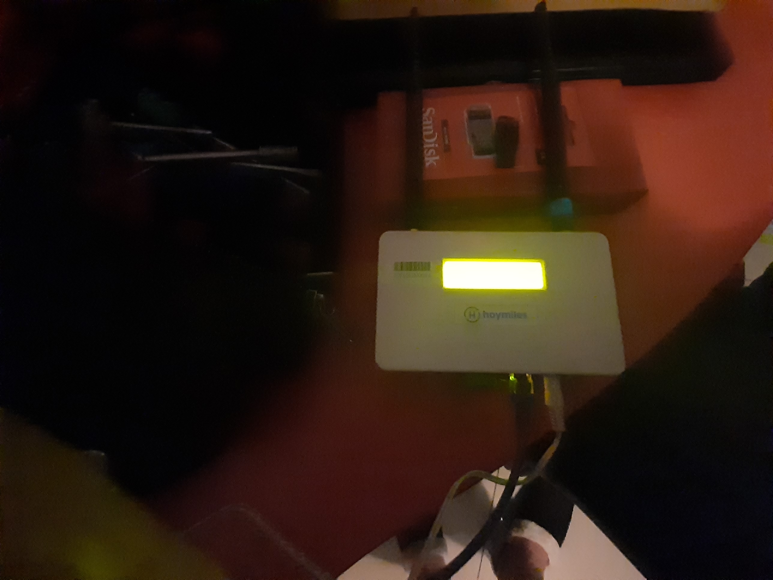

September 7, 20215 yr It looks like I sorted out the meter setup by ignoring the serial number of the meter. I have used a couple of 0 and 1 at the end. This however did not fix my export issues but at least I can see the grid power draw. At the moment I use a smart plug to disconnect my solar when my geyser is not on. The image is when I do not use the smart plug to control the solar. If anyone has a DTU-Pro with Zero export working, please contact me if you can help. 0796951133 Thanks. Jordaan Botha
