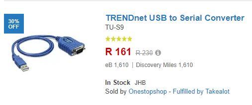

Jaco De Jongh Posted November 13, 2019 Share Posted November 13, 2019 13 hours ago, Boertjie. said: But cant find the right adaptors!!! Hi Boertjie, when i last did a firmware upgrade on a Voltronic I used a normal USB to Serial Converter together with the cables supplied with the inverter. I guess it will still work. Quote Link to comment Share on other sites More sharing options...
Boertjie. Posted November 13, 2019 Share Posted November 13, 2019 Hi. I have tried two different ones no luck. Let me maybe see if i can get another one. Thanx. Quote Link to comment Share on other sites More sharing options...
Jaco De Jongh Posted November 13, 2019 Share Posted November 13, 2019 2 hours ago, Boertjie. said: Hi. I have tried two different ones no luck What cable do you connect to this adapter? (The one connecting to the inverter?) Quote Link to comment Share on other sites More sharing options...
Boertjie. Posted November 13, 2019 Share Posted November 13, 2019 50 minutes ago, Jaco de Jongh said: What cable do you connect to this adapter? (The one connecting to the inverter?) Hi. The cable supplied with the inverter. It is possible csn we maybe have a chat on whatsup or so? 0741111369 Quote Link to comment Share on other sites More sharing options...
ProjectGKR Posted November 17, 2019 Author Share Posted November 17, 2019 On 2019/11/13 at 9:48 AM, Boertjie. said: Hi. I have tried two different ones no luck. Let me maybe see if i can get another one. Thanx. I got hold of the cables that plugs into the serial port of the inverter (the RJ45 port). I still have a laptop with a serial port, which might make life easier as not all serial to usb converters play nice Quote Link to comment Share on other sites More sharing options...
Boertjie. Posted November 17, 2019 Share Posted November 17, 2019 40 minutes ago, ProjectGKR said: I got hold of the cables that plugs into the serial port of the inverter (the RJ45 port). I still have a laptop with a serial port, which might make life easier as not all serial to usb converters play nice Hi. Thanx. I think i got hold of the right cable now. Waiting for it. Will be here on monday or teusday. But if not working can you whatsup me. Then i can arange with you. Thanx. 0741111369 Quote Link to comment Share on other sites More sharing options...
