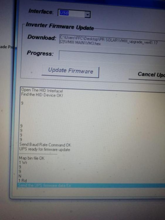

Thanks for sharing the website link. My VMIII 5KW inverter is showing up an error code 32, i have tried to install 41.16 version as shared  by Henry, but i am getting an error saying "firmware update check ready error" should i try with 91.20 version of firmware? is this compatible with VMIII 5KW as i have attached picture of my inverter in above message. please advise how to resolve this issue.
Is that using the USB stick method? If so, perhaps try the PC method? You will need a compatible USB to serial adapter, and a Windows PC.
Thank you for your prompt reponse. I have tried both using USB stick method and RS232 serial port method using a windows 7 installed PC, but the installation gives an error every time, though the remote panel reflash software got installed 100% with no errors but main firmware is giving error. What do you think might be causing it?Should i try 91.20 version firmware and is it compatilbe?  Can you suggest a solution?
Oops, I see that you posted photos of both methods already. My bad. Trying to get through a lot of messages quickly.
31 minutes ago, Tariq Bugti said:
Should i try 91.20 version firmware and is it compatible?
Fault code 32 is a failure of communication between the removable display and the main DSP inside the inverter. So trying different firmware is most unlikely to work.
Your inverter does seem to be a genuine one, at least from the photos. Is there a date sticker over a screw near the large sticker with the bar-code?
If it's a clone, those messages suggest to me that perhaps the inverter doesn't have the right bootloader, in particular "Firmware update check ready error". That suggests that the reflash tool sent a command to see if there was a bootloader, and the command was NAKed (bootloader not present).
Oh, wait! I see that you are attempting to reflash with dsp.hex. As far as I know, all VM III firmwares are vm3.hex. You seem to be trying to update with King or other firmware. I just checked and 45.16 definitely has vm3.hex. Unless this is a bug in the reflash tool... I'm vaguely remembering such a thing. [ Edit: Nope. I just checked it, and it showed as .hex. You should be using the UPSReflashTool. ]
Please confirm that you definitely have the correct firmware update file, and are running the reflash tool that resides inside the folder that archive extracts to.

Yes my inverter is made by Voltronic power and is being sold by brand name OneX in my country. Yes there was a sticker over the screw near large sticker it mentioned 06/2019.
If the inverter doesn't have the right bootloader then how come it installed another .hex file for  display remote panel firmware which got installed 100% after installation the display screen restarted. I think i suggests the inverter has its bootlaoder working, what do you think?
You have rightly pointed out the updating with dsp.hex file, i have deliberately changed the file name from vm3.hex to dsp.hex, while the file remains tha same as inside the archive folder has it. I have downloaded it from the website (https://www.ostrovni-elektrarny.cz/support/Axpert/FW/) you had uploaded. But the error remains as it is even after several attempts. Can't figure out why its happening. I have searched through internet couldn't find anything.
? What do you hope to achieve by that? It only confuses things, and makes it possible to do goofy things like uploading a King firmware into a VM3 machine. That's not going to end well.
I forgot to answer that question. Because the removable display can update its own firmware without the intervention of the DSP and its bootloader; the removable display has its own bootloader (I presume, I've not bothered to find it).
Are you going to illuminate me with the reason for renaming the vm3.hex file? I like to learn 🙂
I had tried vm3.hex several times it didn't work then i changed the name just to see if it changed anything. Chaning the name didn't make any difference both the times same error was poping up. I don't think that changing file name from vm3 to dsp would cause any change in hex file it self or make it king firmware.
So you think its the DSP/main board bootloader which isn't working. Then what do you propose for a solution?
I have answered the renaming file in my previous message it had no technical basis, just an intuition based attempt. :)

here is latest on the topic, i have succeeded to install vm3 firmware on my inverter. This is how i did it.
  • Replaced my complete LCD panel with another one from a friend who has the exact model inverter as mine.
  • Upon clicking to update the firmware it started installation, and after ten minutes the installation completed, inverter restarted and all parameters came back. inverter became functional.
  • After installlation of firmware i installed back my own LCD panel, and it again showed up fault 32. Now that inverter starts up given 230 volts on its output as measured from voltmeter externally, fans / relays are working.
  • i have also installed firmware for remote panel display mcu, the installation gets complete but same error 32 pops up.
  • I detached the detachable lcd of my inverter and installed it on my friend's inverter the lcd itself is working fine, then upon further disassembling i found out there is another pcb card where two wires coming from inverted get terminated. There is something wrong with that card, though visually it looks fin
  • What do you suggest after current situation? @Coulomb @ShaddersPlease share your feedback

Finally diagnosed the root cause of the problem, the communciatin card on removable display panel where two cables coming from motherboard is messing up / faulty. I have changed this card with another one from a friend's inverter after which my inverter started working flawlessly. I am posting the picture below. Is this repairable? Which component might have stopped working? there isn't much on it just a transformer, capacitors, smd resistors etc.
But didn't the successful main firmware update happen through this "faulty" comms isolating board?
Maybe it's just marginal, working only with certain removable displays. The most likely components to become marginal in my opinion are the two opto isolators, the two largest 4-pin components under the board. These can be ordered from Mouser or the like; shipping will likely cost 10x the cost of one part.

No the successful main firmware update happened through another display panel(including the isolating board) which was working fine. In my inverter's case the isolating board was the reason my firmware updates were getting failed.
Your are right and i am happy to tell you that my issue is resolved, i checked its opto couplers and one of them was faulty, i changed it with a new one and the inverter has come back to life. I did that ealier today, now that you too have shared fixing a similar problem being recified by changing optos.
My inverter is working fine now, with both main and display firmwares updated.
Thank you very much for your continous replies and help. :)
Hope this thread will help those who are struggling with same issue.
