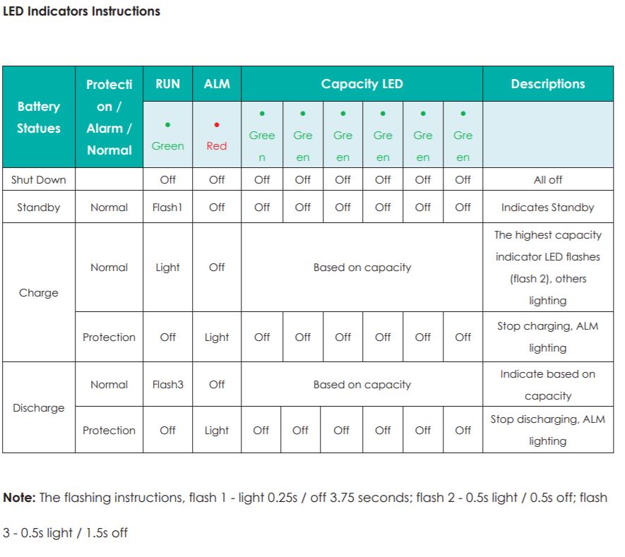

wolfandy Posted July 7, 2020 Share Posted July 7, 2020 23 hours ago, Tursiops said: The only lights on the batteries are the LEDS showing that the battery is turned on, but all the others are dead. If the Pylon is not being either bulk charged or discharged it goes into standby mode and the SOC LEDs will be off. Only the green RUN LED will flash intermittently. Detailed LED status from Pylon manual here (am somehow struggling to upload pictures) Have you disconnected the Pylons and measured the voltage across each battery's terminal individually? Do you still get 0V? I had a similar problem a while back. In my case, it turned out that my installer had not properly tightened the connection at the top of the fuse between the Pylons and the inverter - and this caused the disconnect. After frantically chasing around with a multimeter for a while, all it took to fix was a few turns with the screwdriver to tighten the connection Quote Link to comment Share on other sites More sharing options...
