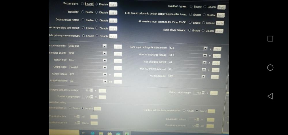

Hello, just another question, I have the amps set at 80 now, what should the back to discharge voltage be, i currently have it at 56V, and the back to grid voltage at 45V and what should the bulk and float charging wees.

Per inverter? 20 A per battery module (C/5) seems very cautious, especially for a maximum figure.
Quote
Despite the manufacturer recommending 54.0 ± 0.5 V, I'd go with the voltages that work best for Pylontechs (which are also 15S LFP).

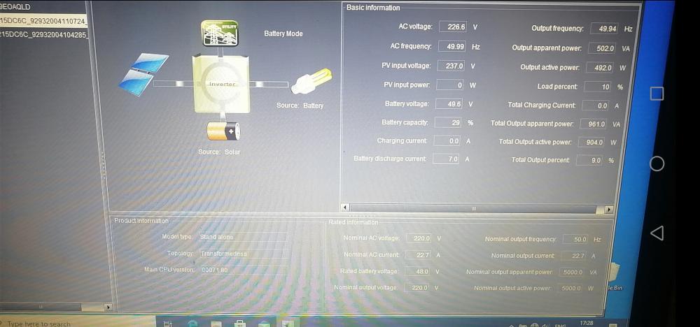

Thank you Coulomb, I did the settings as said, at the moment with the sun at full steam the batteries is floating at 51.9V but the SOC on watchpower sais it is charged at 52%. Isnt it suppose to be 100% now?
