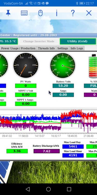

Axpert King 5kW and Pylontech 3.5kW. It seems the inverter is constantly charging as the charging symbol is animated.

Inverter shows it is charging all the time although I activated Bypass.

These are manufacturer's recommended settings. The battery voltage settings are too high for Axperts to aim for, so find the firum recommended values (52.5V etc).
It might even fix your current problem. What voltage does the battery charge to, according to the inverter?
