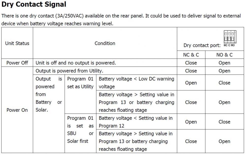

The Axpert 5kva (not sure of the smaller ones) does have this also
For off grid with a gennie, I would leave it on Utilty mode so that if it's available charge the batts and run the load from the gennie.
If the gennie switches off the system will transfer to  batt/solar mode and you won't even notice it except for the gennie noise that suddenly disappeared  ;)

I'm sure if you give Edmund some time he can control this contact with software and use the BMV SOC. I need the BMV relay to start my geyser element on good sunny days ;)
1 hour ago, viper_za said:
I'm sure if you give Edmund some time he can control this relay with software and use the BMV SOC.
But Frans does not. So he can do it on SOC for I suspect by the time the smaller bank hits set SOC, the volts will fluctuate a bit.
Frans does not need any software, use it as is with appropriate goed between relay and generator to start / stop it. Techie side escapes me ... just make it work - as I always say to the developers.
Ps. Have asked Ed to look at altering BMV SOC settings, to trigger said relay, but for other nefarious reasons ... you just gave me another idea Viper. Thanks.
