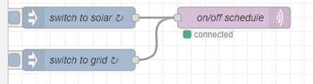

Good day to all.
This is the command in node red to change from solar only, solar battery utility and grid;
  • solpiplog/pip/status/set with payload uti, sol, sbu for example: solpiplog/pip/status/set uti to change to grid.
This works fine in node red to change to solar to say at 07:30 and back to grid at 16:00. Problem is to change the charging priority from solar
to grid or solar and grid in that time when solar is not enough just before the sun disappears completely.
......and this the commands to change charging source;
  • solpiplog/pip/status/set with payload 0, 1, 2, 3 for charger settings.
This does not work or I am doing something wrong.

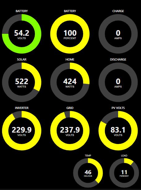

I have a simple interface at the moment so I can see at a glance what is going on.
As you can see, everything works fine, it's just that one command I'm having trouble with.

The code to set charger priority looks correct to me. There is an open issue on the github page addressing this very problem so the issue is with solpiplog itself.
My personal approach in light of this would be to set the charger settings to what suits me best and then by changing output priority keep the battery SOC in the desired range. e.g. set no ac charge, and have inverter in sbu when battery voltage is above 53V and change to uti when below.

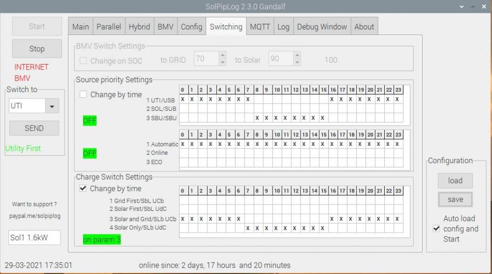

Solved the issue by doing this in solpiplog
So, I'm using solpiplog to only change the charge switch settings and node red to change the source priority. Works well.

BTW, I have at last added the 2 panels for a total of 6*400w at a 30degree angle. ( hope this is good year round) Managed to get 2200w at noon today and it was a bit hazy. (had to start my wife's hairdryer and toaster)
