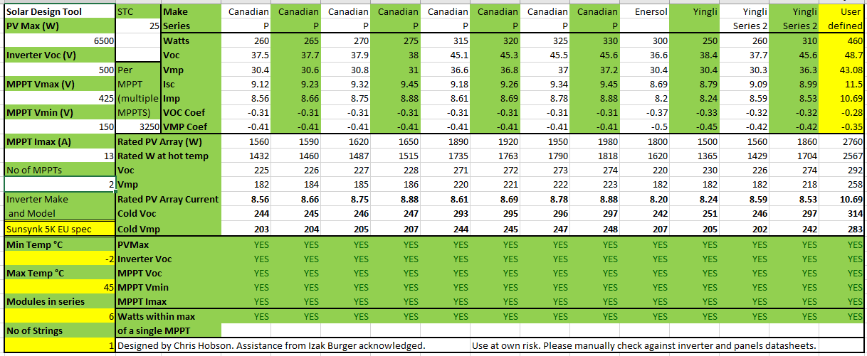

So looking at the inverter specs,
It has a max DC input voltage of 500V, MPPT range is 125-425V and Start Up Voltage is 150V
The Jinko Tiger Mono panel specs below,
460W     (STC)
Vmp    43.08V
Imp    10.68A
Voc    51.70V
Isc    11.50A
6 panels equate to 310.20V which is within the operating range for the inverter with some head room to expand on that string should I add a panel or two.
I've also input the panel specs in the PV String tool and the results are attached.
Does this look feasible?
Many thanks,
daWolf
460W     (STC)
Vmp    43.08V
Imp    10.68A
Voc    51.70V
Isc    11.50A
Many thanks,
daWolf
Apologies, looks like my inverter data was fiddled with. Fixed in this version. Somehow it doesn't calculate for 2 MPPTs, but that's OK
It looks good, note that I adjusted min temp for Midrand as -2, but it isn't plausible that it will reach -2 at 12H00. Great panels, you could probably go up to 8 in series, great for cloudy days!
