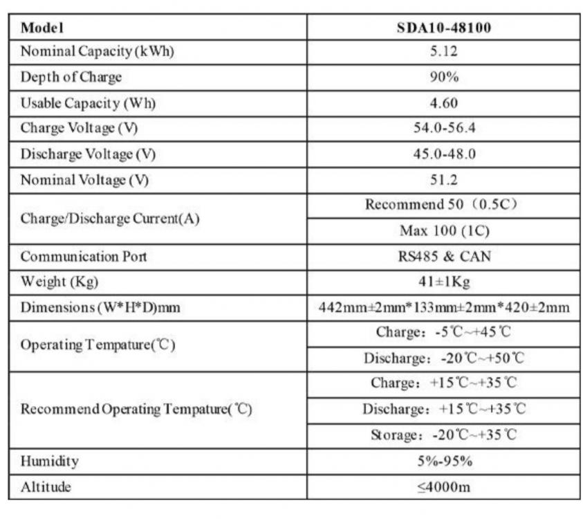

SebastiaanR Posted August 1, 2021 Author Share Posted August 1, 2021 Sorry, of course. It's a Shoto SDA10-48100 (5.12kWh) 100Ah/48V. Quote Link to comment Share on other sites More sharing options...
Buyeye Posted August 1, 2021 Share Posted August 1, 2021 Specs say 90% DoD =4,6kw. If you want to get that you need to put in 5,12kw. Quote Link to comment Share on other sites More sharing options...
