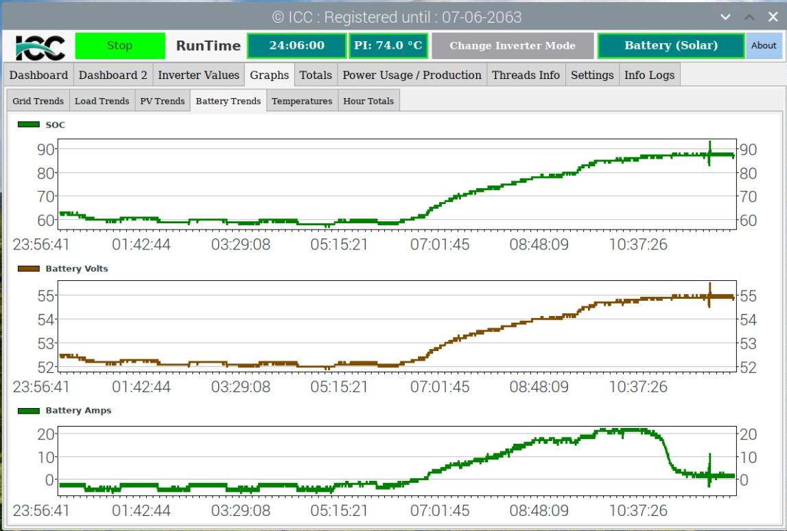

November 4, 20214 yr I recently bought 16 x 3.2V LiFePO4 cells, they were top-balanced before assembly into a 48V battery and then connected to a Axpert 5kVa Inverter/charger. The Axperts' settings are 55V max (3.44V per cell), 48V cut-off (3.0V per cell) and monitored remotely through a Pi with ICC. A 2A active balancer is permanently connected and currently there is a variance of about 0.085V or less between cells. Temps below zero are not expected. I've been told that this is not sufficient and that a BMS MUST be used and that an active balancer should NOT be connected permanently. Is this correct?
