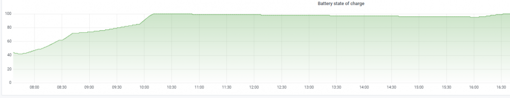

In my case it shows anywhere between 0,4 and 1 A discharge as soon as the battery is at 100% SOC. It takes about 6 hours to reach the 95% SOC and then starts charging again.
Today was a good sunny day so my geyser was hot and the battery fully charged just after 10:00. My usage never exceeded the available solar power today and you can see the steady battery usage as soon as it was at 100%. At around 16:00 it started the charge again.  image.thumb.png.dcbcb89f50e6ff9d7e78865c3fddfb04.png

With a battery with comms at least it only goes down to 95%. As much as this wastes solar power and cycles the battery unnecessarily at least it's still fairly viable. With dumb lithium batteries its a much bigger mess because the battery discharges deeply even when there is power available.

I recently installed a Growatt SPF5000ES, with a Hubble AM-5 with comms. No solar, so using it as pure backup.
When the utility supply is present the battery also charges to 100%, drops down to 95% over time then charges to 100% again.
