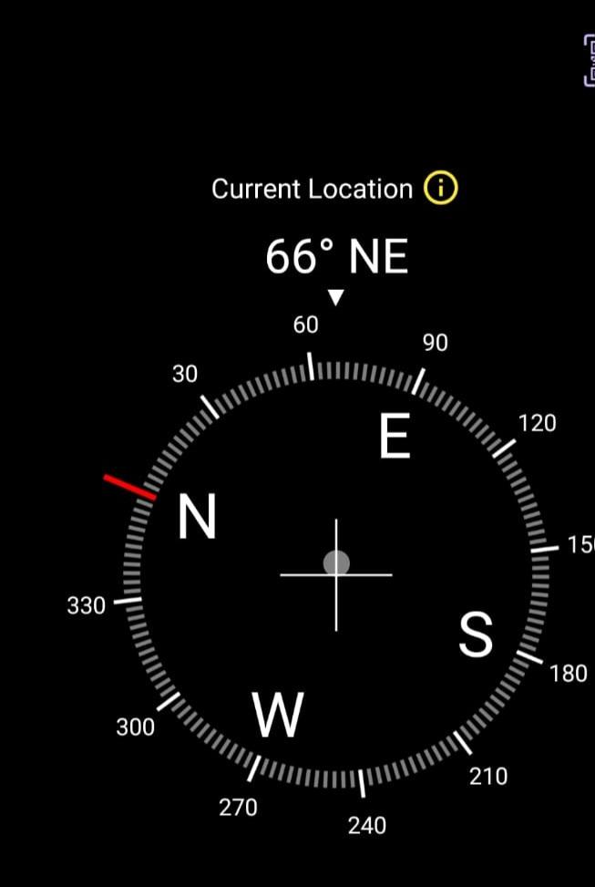

Sorry to butt in here, we need to know how many degrees NE is your roof direction because if 25° NE will yield more in the afternoon compared to 66° NE so if you can indicate the true NE direction it will help determining the best yield but i personally will go for Option B.
How do I check the degrees you speak of in your comment?
I think @TaliaB is looking if NE is at 45 degrees or more north or more east of the 45 degree.
Your option B with 8 panels should yield more if NE is at 45 degree or any angle towards north.
You can also look on Google maps and use the satellite layer. North is normally at the top of the screen display.
I use an digital compass for my assesments to determine the true direction.
