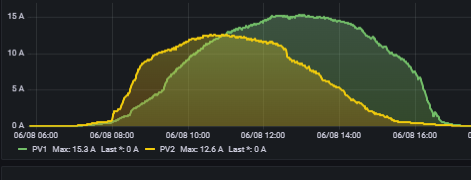

East and West facing strings are preferable if possible due to the longer hours of production if slightly lower total than a N facing string. The yellow part of the chart if from an North-East facing string the green part is from a  NWest facing string
Thanks, so you are saying I should rather do NW facing 8 panels of 535W (4280W production) on one MPPT String (331V, which is less than 425V) due to the longer production time in that direction. And rather not face it N?  If this is the case, I would need to see if I have space NW....
No, the idea is to have your two strings split in East & West directions so you have a longer period of time of making good solar power.  East facing panels get the morning sun and start making power earlier than North facing panels but power drops of earlier. West facing panels get the afternoon sun and make power for longer in the afternoon but only start producing power later in the day.  If you have a split setup with East and West facing panels you will get the early morning sun from the east panels and the afternoon from the west facing panels.
You can see in the chart I posted the yellow East facing string produces peak power @ about 11:00 whereas the West facing green string produces peak power at about 13:00. This will result in a flatter top max power production vs 2 purely North facing strings and probably more power if you are maxing out the DC power production of the inverter.
It really depends on what usable area you have on your roof and what directions the panels would be facing. A East/West split (or NE/NW) is definitely preferable to a purely North facing panels for domestic use, especially if you are maxing out the power per string.

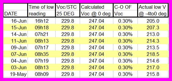

@Sc00bs
"It is very important not to go over 425V on each string, otherwise you can have smoke & fire from your MPPT controller. "
With the sweet spot 125-425V and the maximum only at 500V why do you think one could have smoke exceeding 425 but still below 500V as per the specs. Is it not that you might loose just a percentage or 2 between 425 and 500V?
