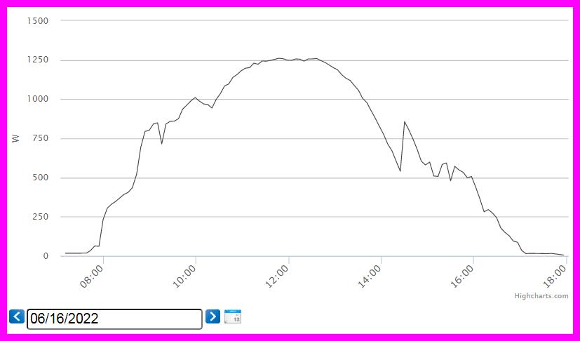

With the current cold spell it is perhaps a good time to chat about temperature affects. Bear in mind this is not advice but just actual inputs to consider based on real data.
As irradiance is not taken into account as it has a very small effect on voltage but a direct correlation to the current produced.
Firstly consider the temp of the panels on a chilly day. Maximum temp about 16 degrees yet the panels are at over 40 degrees. The maximum power is generated when the sun hits the panel at the best angle from east to west. Panels are at 28 degree fixed angle. All power is used and not dependent on load or battery. This is what I meant in my previous post that I feel the lower temp earlier/later in the day does not produce more power. We have no control over it so no need to try and alter it.
Power generated at the temp of the above graphic.

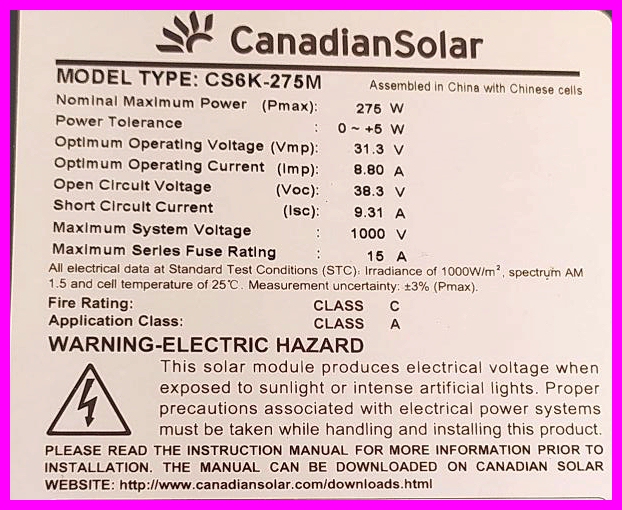

This table below adds to the post from @Sc00bs @P1000 and @Solarcrazy and the specs for the panels used is for a Canadian Solar which is used as a 6 in series single array. I used the lowest temp during the day from 19 May up to today. I normally look at the ambient temp in the morning and no chill factor is needed. We had at least 5 days where the temp was zero or lower up to minus 4 just before 07h00. Calculated Voc at a temp of zero works out at 247V. Actual figure shown does not get even close to it. This deviation from calculated to real life is what I have been observing over the 40 months that I have data available. Further to this I have also never had a Voc as per STC at 25 degrees at temps below zero. This does not mean Voc cannot go so high purely because it has not been the case in 40 months even on below zero ambient temperature.
Specs for the panels.
Table with the calculations and real measured Voc values on a few zero and below mornings. Today the Voc was not early in the morning but in the late afternoon.
If the post is too long just page down :)
So I looked at the spec sheet of the Canadian panels. There seems to be 2 specs (Standard test conditions (STC) and Nominal Operating Temp (NMOT), each have different VOC value. Which one do I use for my calculations of my max string?
