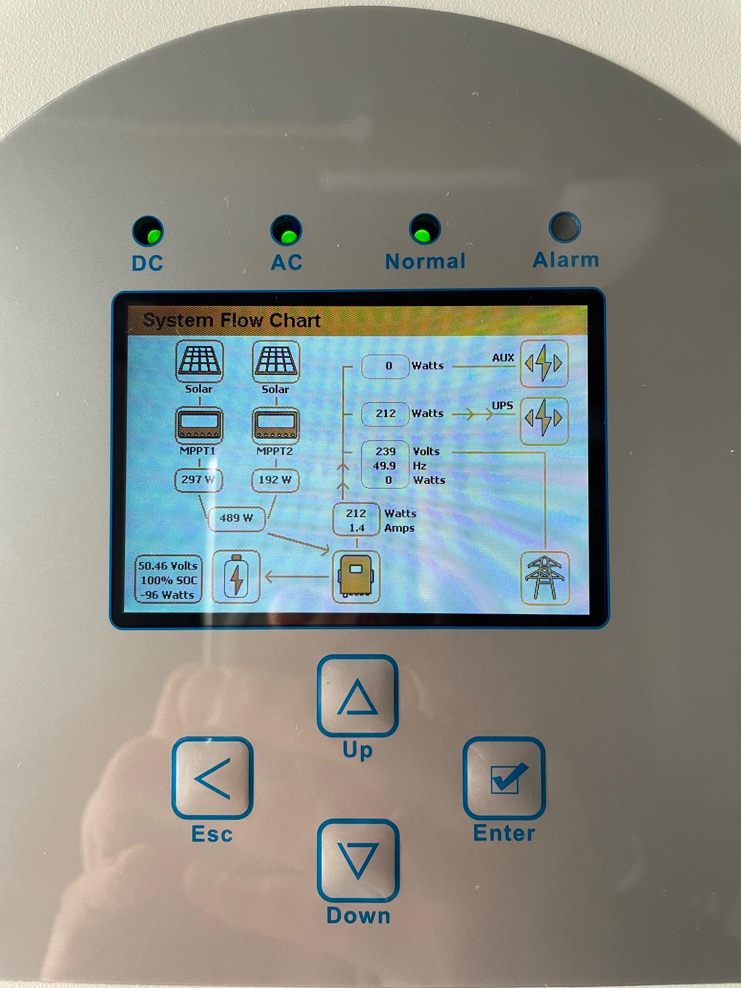

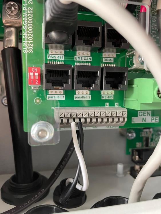

June 16, 20224 yr Hello all. I am hoping you can help. When I installed my Sunsynk 5K, I connected my CT coil locally at my inverter just to test and the little house and coil picture was visible on my flow chart. I then made a number of settings changes and moved my coil to the main DB feed which required the cable to be extended by 8m which I did with ripcord (1mm thick). Putting everything back together and the house is not on the flow chart. I checked everything the wiring and nothing brought it back. I have since moved the coil back to locally at the inverter on the built in cable only and still nothing. I have power cycled the inverter and still nothing. Could it be a setting that I change the is stopping this from working? Could I have damaged the coil? Any ideas?
June 16, 20224 yr 1 hour ago, Jay-Dee said: Hello all. I am hoping you can help. When I installed my Sunsynk 5K, I connected my CT coil locally at my inverter just to test and the little house and coil picture was visible on my flow chart. I then made a number of settings changes and moved my coil to the main DB feed which required the cable to be extended by 8m which I did with ripcord (1mm thick). Putting everything back together and the house is not on the flow chart. I checked everything the wiring and nothing brought it back. I have since moved the coil back to locally at the inverter on the built in cable only and still nothing. I have power cycled the inverter and still nothing. Could it be a setting that I change the is stopping this from working? Could I have damaged the coil? Any ideas? Hi. The house icon on the flow chart has nothing to do with the CT coil being installed or not as some people believe. Untick Limit to Load and the house icon should appear.
June 16, 20224 yr Author 4 hours ago, Leshen said: Hi. The house icon on the flow chart has nothing to do with the CT coil being installed or not as some people believe. Untick Limit to Load and the house icon should appear. Thank you so much..!!! Perhaps you can answer a question... What is Priority Load vs Priority Batter Sorry, I come from an Axpert, so this is all new to me
