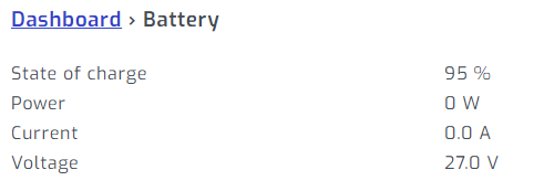

Thanks Coulomb,
Sadly there are no other battery current graphs or values in Solar Assistant.
During load shedding:
During charging:

Indeed, both display and Solar Assistant says 0 Amps during charging.  But it certainly charges.
