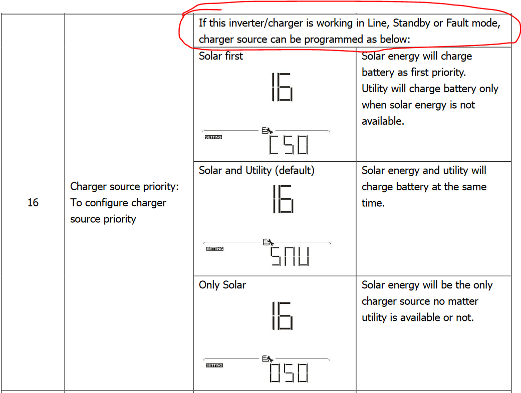

August 16, 20224 yr From what I can gather from my Axpert MKS IV manual it seems like these settings are only available when in line (SUB)(USB), standby or fault mode. So your screenshot is showing that you are in line mode - it should be using solar and utility (SNU) to charge. In battery mode (SBU) I assume its always solar first mode CSO. Edited August 16, 20224 yr by Douw Gerber
August 16, 20224 yr 34 minutes ago, Douw Gerber said: From what I can gather from my Axpert MKS IV manual it seems like these settings are only available when in line (SUB)(USB), standby or fault mode. So your screenshot is showing that you are in line mode - it should be using solar and utility (SNU) to charge. In battery mode (SBU) I assume its always solar first mode CSO. On the older Axperts as well as this picture there is a solar only. CSO I think on the older ones and OSO in this picture. Confusing if different letters are used on different models. Edited August 16, 20224 yr by Scorp007

August 17, 20224 yr Author On 2022/08/16 at 4:54 PM, Douw Gerber said: From what I can gather from my Axpert MKS IV manual it seems like these settings are only available when in line (SUB)(USB), standby or fault mode. So your screenshot is showing that you are in line mode - it should be using solar and utility (SNU) to charge. In battery mode (SBU) I assume its always solar first mode CSO. I am using SUB mode, solar utility battery. And with SNU solar + utility for charging priority
