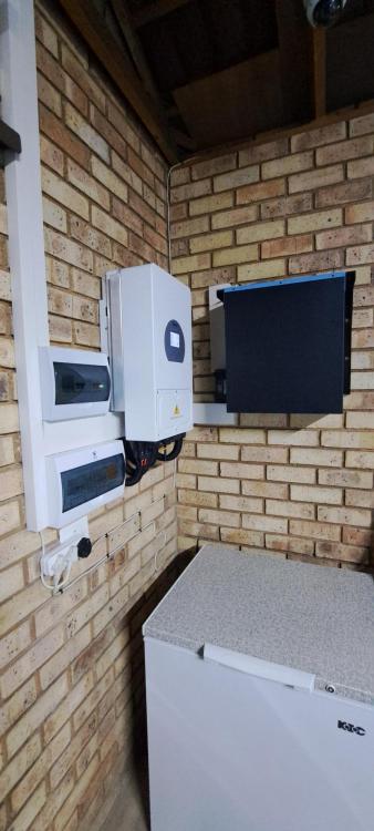

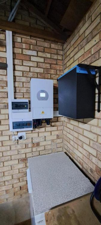

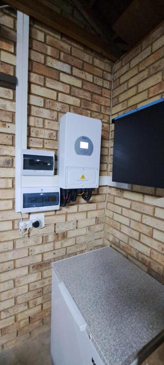

Happy to join the solar power backup club but still have plenty to learn, Have a entry level system installed 7 days ago.... Deye 5kva Inverter and Greenrich 5kwh lithium battery with 10 x 455watt panels. See attached pictures of install for reference.

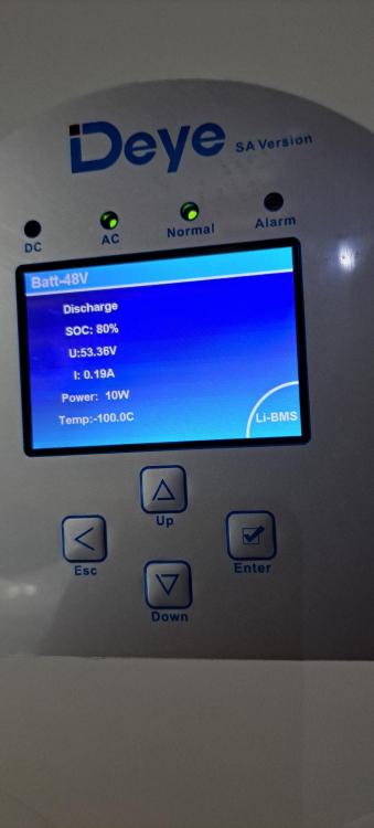

So far the system runs smooth with no issues. Have one problem if anyone can assist, notice the battery on the Deye inverter temperature show -100c, surely this is not correct? Something that I can check on the inverter with settings etc? Inverter connected to battery via coms cable.. Must there be a separate temp sensor installed to measure battery temp?

Just update regarding the battery temp showing -100c,
Was a quick fix, on the Greenrich lithium battery, need to make sure dip switch set to master, even if there is only one battery connected to inverter.

Where did you get your battery mount from?
Those look very much like regular, sturdy shelving brackets. You should check your local builder's warehouse if you are in to DIY.
