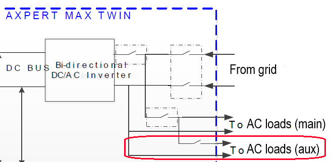

13 hours ago, bholdher said:
I was thinking it refers to twin versus non twin MPPT and since I have twin MPPT it might not be right for me?
No, Twin-ness refers to the presence or not of a second AC output port, with associated relay. Twin models have settings that tell the firmware when the relay associated with this second AC output port should be turned on or off:
The Twin models have different firmware to support the extra commands needed to support those extra commands.
I had a warning on version 69.05, when I upgraded to 69.06 the warning disappeared, and now on 269.61 the warning is back.
Ah, that might be a main firmware fix that is only in 69.06. When I get around to patching that, the warning should go away. So many versions to try and remember 🤔
Ahhhhh now I understand, thanks.

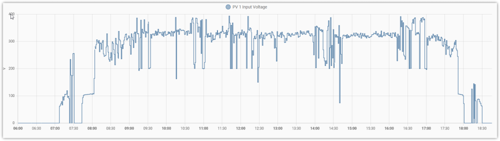

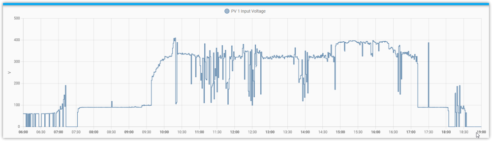

On 2023/10/27 at 6:58 PM, pongo said:
Hello,
I installed version 269.61 yesterday.
Now I can see Voltage differences on morning and afternoon.
Before upgrade (sunny day):
After upgrade (cloudy morning):
@pongo
I come from Italy and I have the same inverter as you, how did you solve the 90V problem? Have you found a firmware with the fix and BMS communication?
Regards
L.
