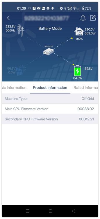

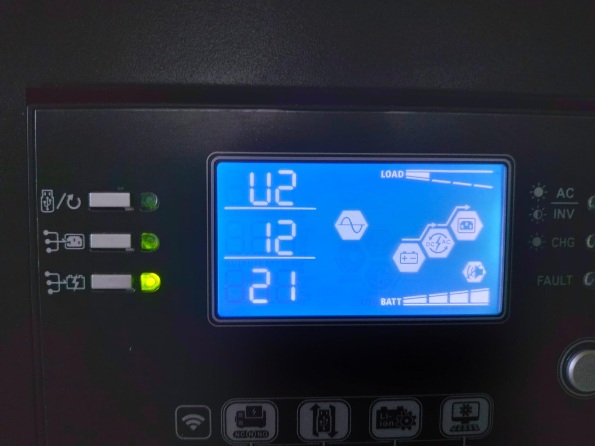

Hello,
I have an Axpert Max 7.2k from SolarPower24, with 90V bug at low light.
Firmware U1 88.02, Display U2 12.21. I don't know which chip it uses.
Which is the best firmware I can install to solve 90V bug?
2023-05-17_01-38-30.thumb.jpg.5f4881b454bcb8c17727634306d458d9.jpg2023-05-17_01-13-39.thumb.jpg.17e388affbfc5f193bd631ce0a63797f.jpg
Edited by pongo
Unfortunately, we have not seen a firmware update file for 88.xx. I've seen 45.xx for the '2809 processor, and 69.xx for the '28066 processor, and various 90.xx firmwares that could be for any model. So I don't know why yours has a different major version number to all these. Maybe there is some minor customisation for your reseller.
The best thing would be to complain to your supplier, maybe they will provide a firmware update file. It almost certainly won't solve the problem, but at least we can patch it to reduce the severity of the problem.
