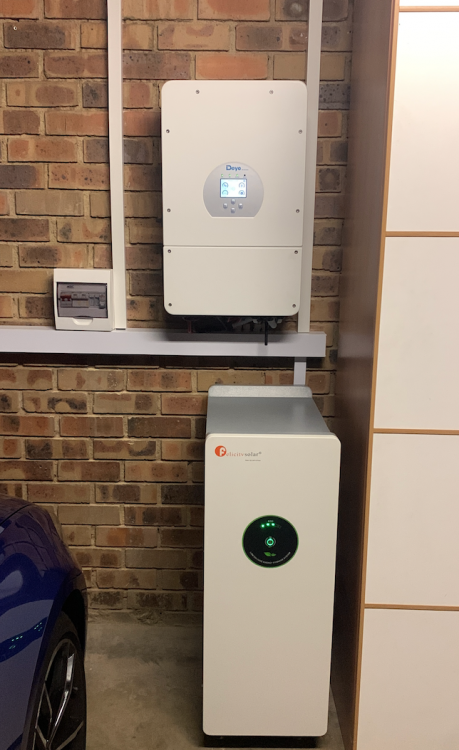

October 27, 20223 yr Very neat installation Do give some user feedback on the performance of your battery over time. Always informative for other users to get first hand real life experience with batteries outside the marketing hype.
October 28, 20223 yr 11 hours ago, zsde said: Very neat installation Agreed! That's some very nice DIY work 👍

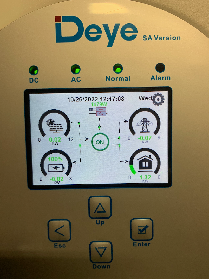

November 28, 20223 yr Author The system after 1 month has been working well. Just one issuse. When there is no grid and the battery gets to 100% something clicks in the inverter and the load gets dropped. I took a video. https://mega.nz/file/FvZX2bKS#1VDU82Lvf3AbXfCb28_s5C0txfquaqTKWh-oUGRRBkA So when it's cloudy during load-shedding and the battery temporarily discharges and when there is enough generation to get the battery back to 100% it flickers again. Deye updated the firmware that did not help. They asked me to test using voltages instead of the BMS it did the same thing. Felicity Solar said they will check something with Deye and get back to me 1 week later still nothing. Besides that I'm happy.
