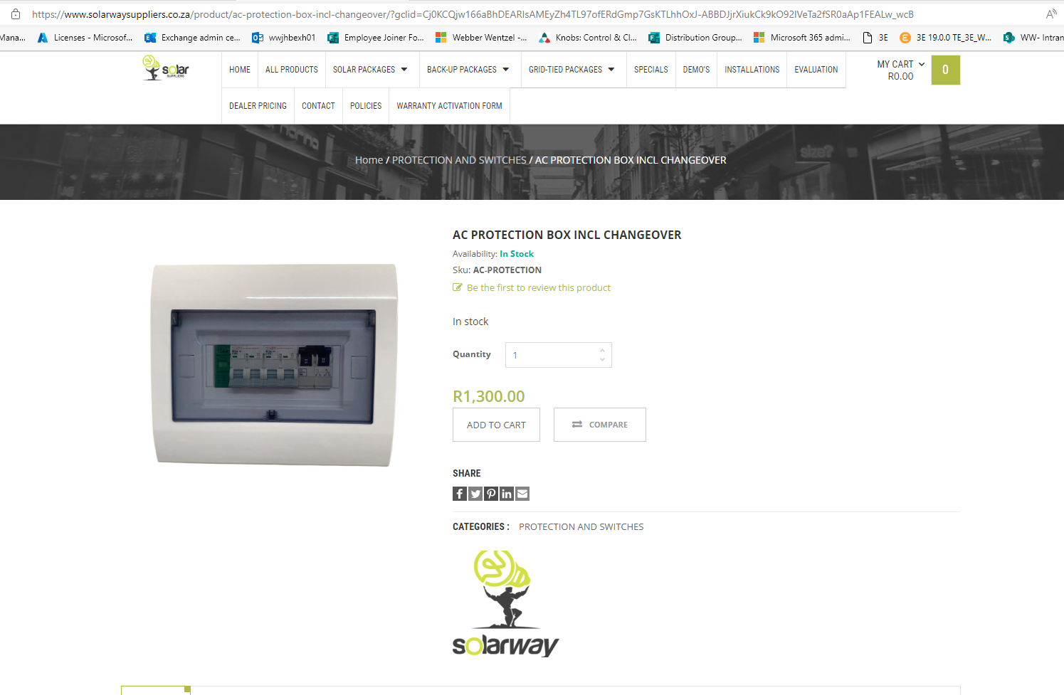

ive attached a pic of the inverter and what the plugs are like as well as the auto change over switches / panel i was looking to get to add to the inverter output next to it

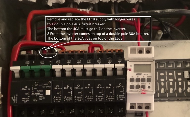

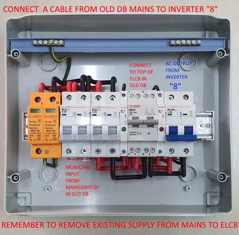

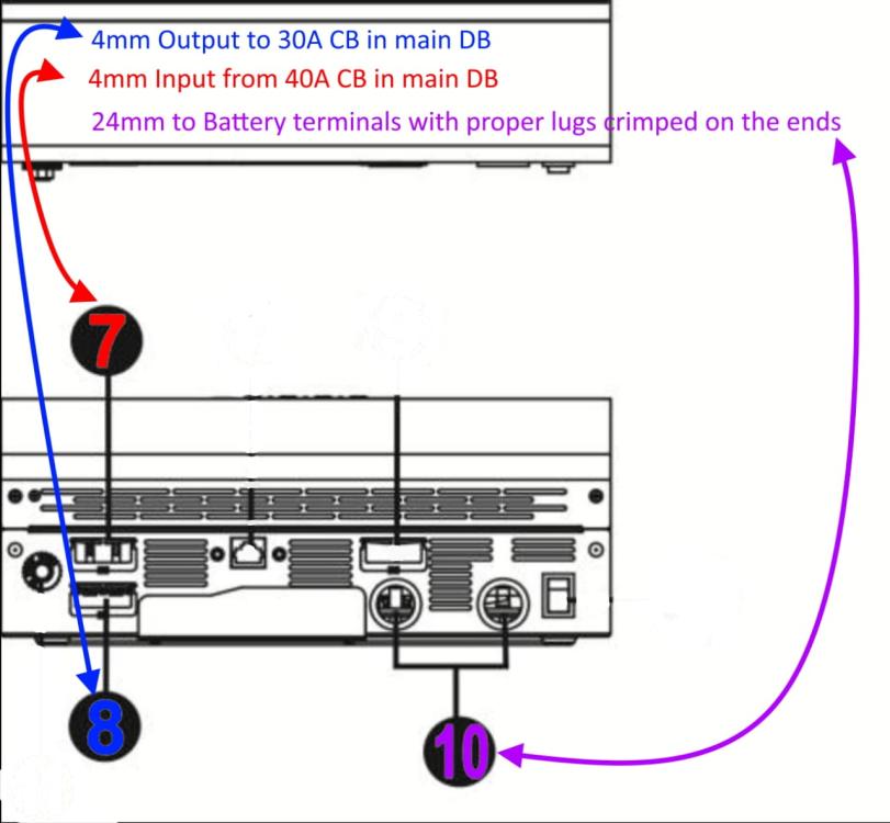

I'd like to add the auto change over and earth leakages etc. like the ac protection box in the pic
for now, I'll just run it to my change over switch outside my house that disconnects the mains and can connect a genny or inverter
I'll look up how to connect it to my DB then I'll get some wire and start the project
Ok, so I would advise making sure you have a surge arrestor on both in incoming and outgoing lines. Additionally, it would probably be a good idea to get yourself a neutral-earth bond since the MKS series do not have automated bonding when running off battery. An automated genset could be installed or auto-changeover to make for a more seamless transition but a sub-DB with specific points wired to it will also get the job done just fine.

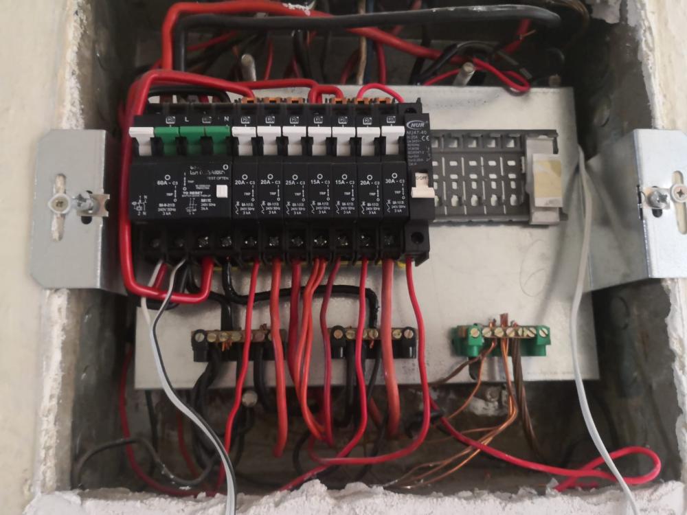

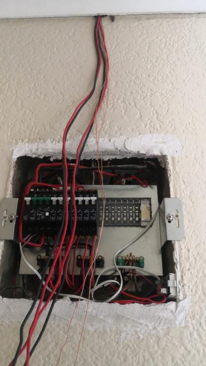

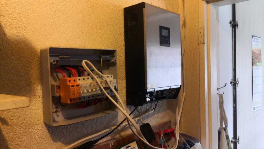

Ok so im making some progress on my install,
i just need a a few thinks to clean it up but im need help with the wiring as im sure there are a few ways to do this so ill attach some pics for thoughts.
ive got the 5kva inverter that should have a auto changeover built in would be nice if power went off and i didnt know due to this keeping the lights and plugs on. dont need stove or geyser but i dont mind putting them off on the db
ive also bought a prewired db for a 5kva inverter if needed.
my cousin inlaw had the same setup installed but he needs to keep switching his change over to inverter as it keeps beeping when using kettle or big load instead of pulling it from the grid.
