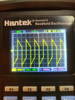

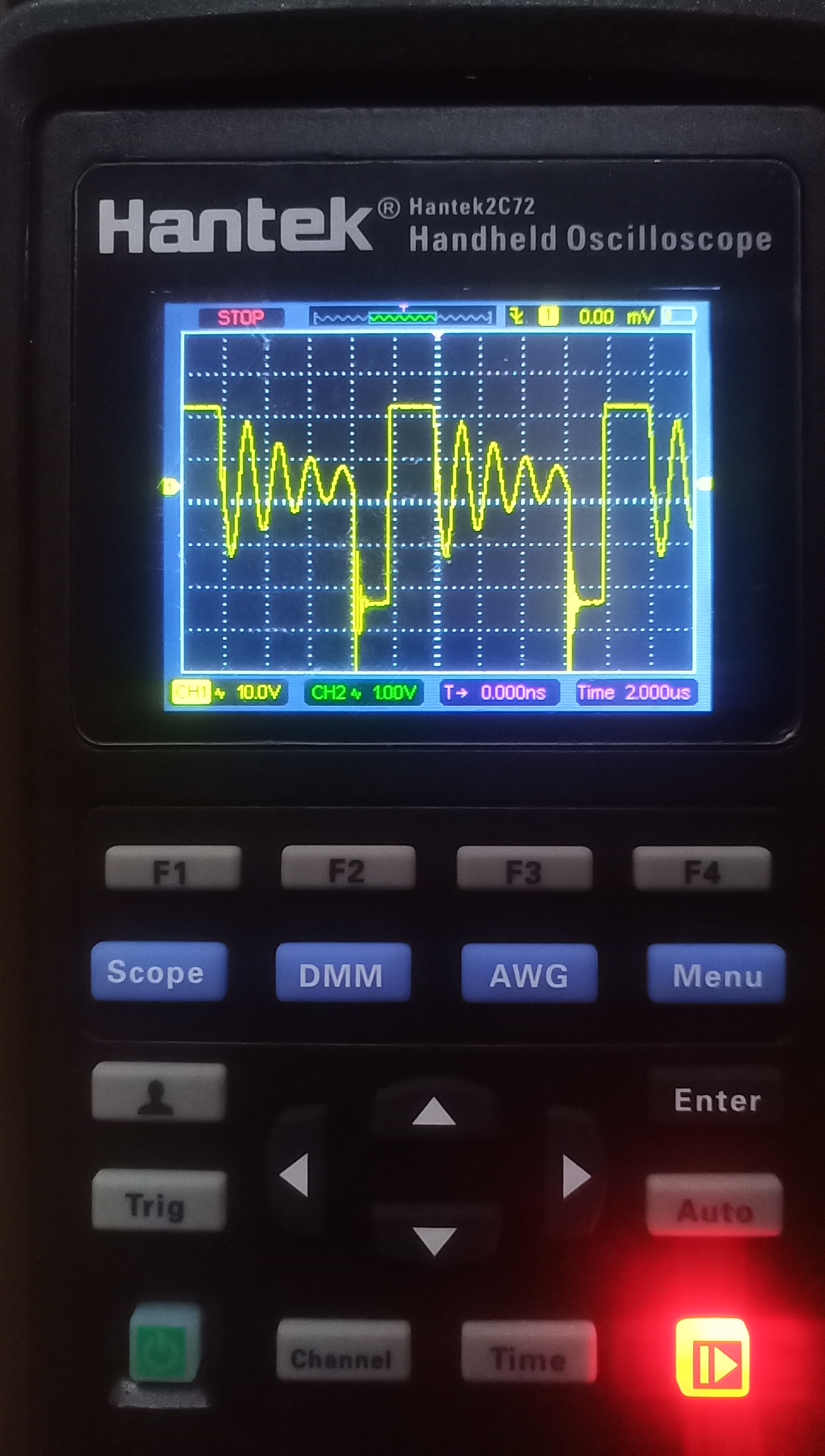

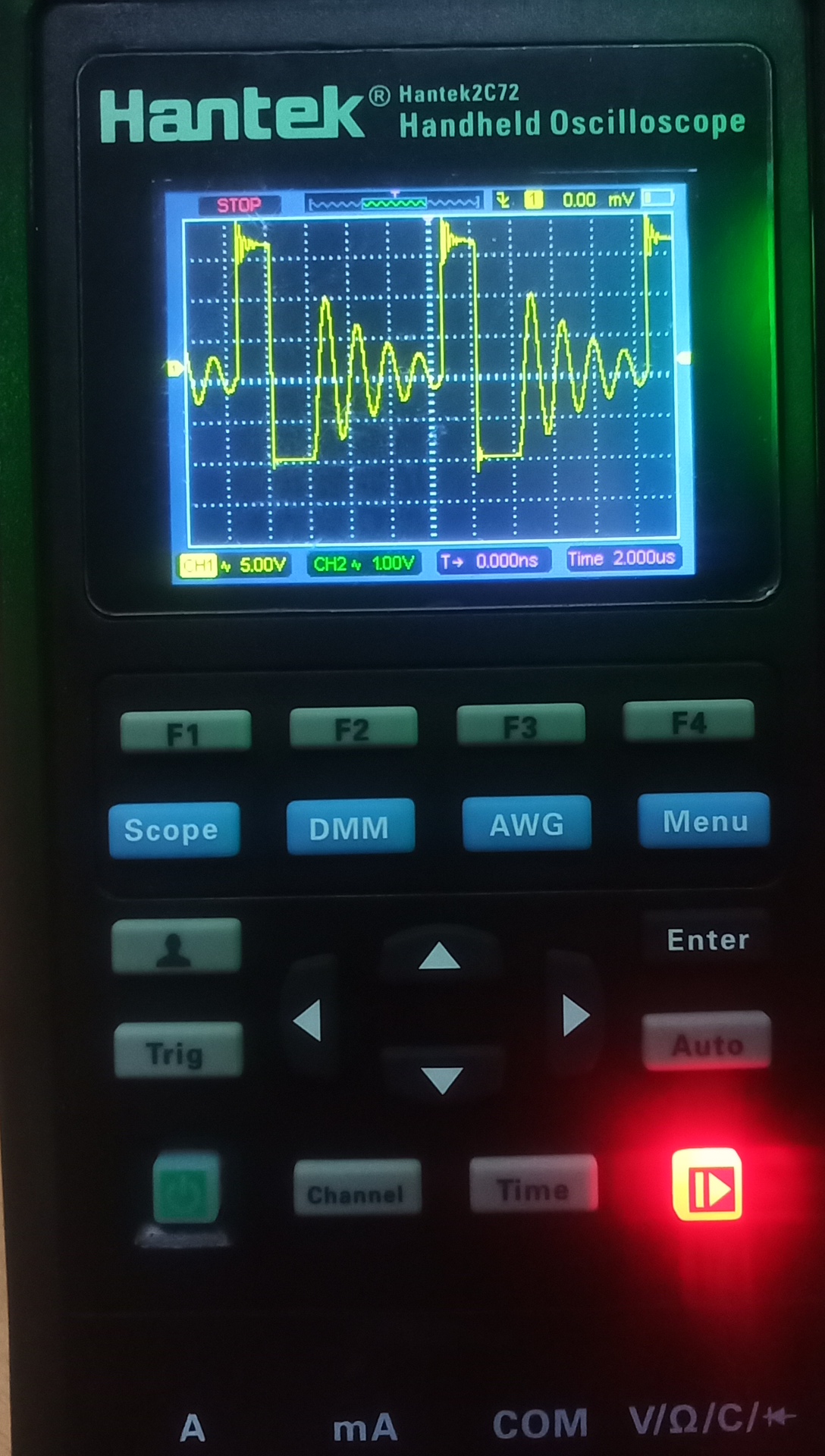

November 8, 20223 yr Hi, I also have a Revo VM II 5.5kW and I have a problem with the Igbt transistors that keep going out. There are four dc/ac outputs. I checked almost everything. The first two have a different sequence of wake-up signals and I don't know if it's OK. Can you confirm the correctness of the difference between these signals? Or measure these signals on a functional converter? Thanks.
November 8, 20223 yr 12 minutes ago, nogers said: Can you confirm the correctness of the difference between these signals? I can't confirm. I can't see the timebase on those tiny photos. I'll assume that it's 10 ms per division. It is normal for one pair of IGBTs to switch at 50 Hz; that's the pair that drives the neutral output. The pair that drives the active is PWMd to generate the sine wave. So that likely explains most of the gross differences. I don't know how exactly you are measuring these signals, but the slope on the neutral output pair is concerning. But that could be a DSO earthing issue.

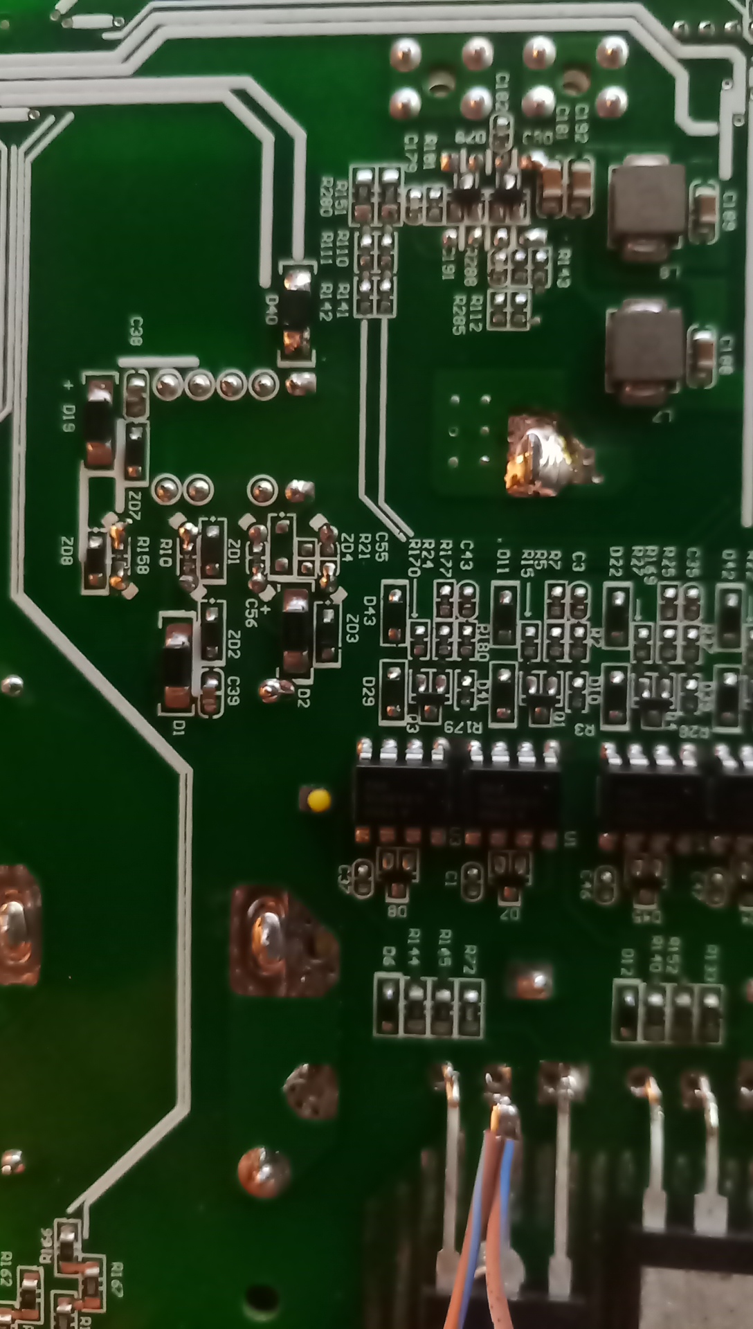

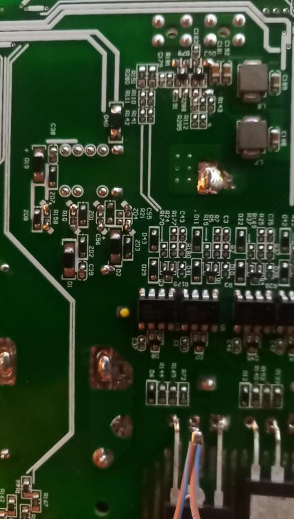

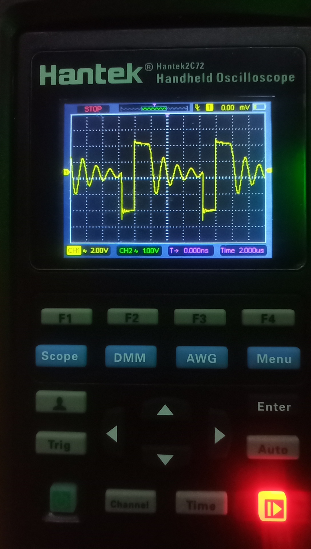

November 9, 20223 yr So measured. Twice -5.5v/ +7.7v QB2,QA1 and twice 0/ 12.1v QD2,QC1. R21, ZD4, C55 is not originally installed on the board. Strange. According to this wiring it works correctly. If they were to function the same, these components would have to be supplemented. Igbt transistors are FGA60N65 in my case. No error found.
November 10, 20223 yr 12 hours ago, Coulomb said: If you accidentally shorted one of the PV inputs to earth, that shorts BUS- to earth, which connects one of the IGBTs across the DC bus. Ouch, something very important to remember 👌
November 10, 20223 yr 17 hours ago, nogers said: R21, ZD4, C55 is not originally installed on the board. Strange. That's possibly the reason for the slopes on your DSO signals. Does it look like they were never installed from the factory? Or could they have been blown off, or taken off by someone else, or ... ?
November 10, 20223 yr These parts were always missing. It's so original. I am the first to disassemble the converter. It was working normally and properly before. It's mine and it worked for about a month until I connected the ground and input from the panels. Is there a pattern of the correct signal (picture)?

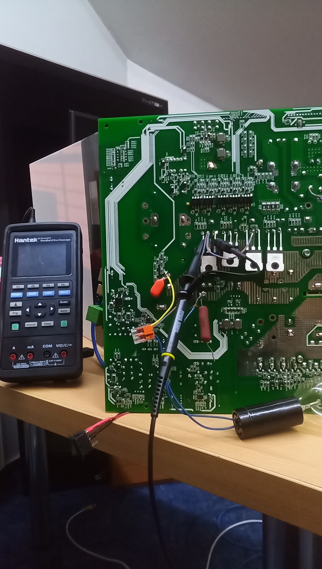

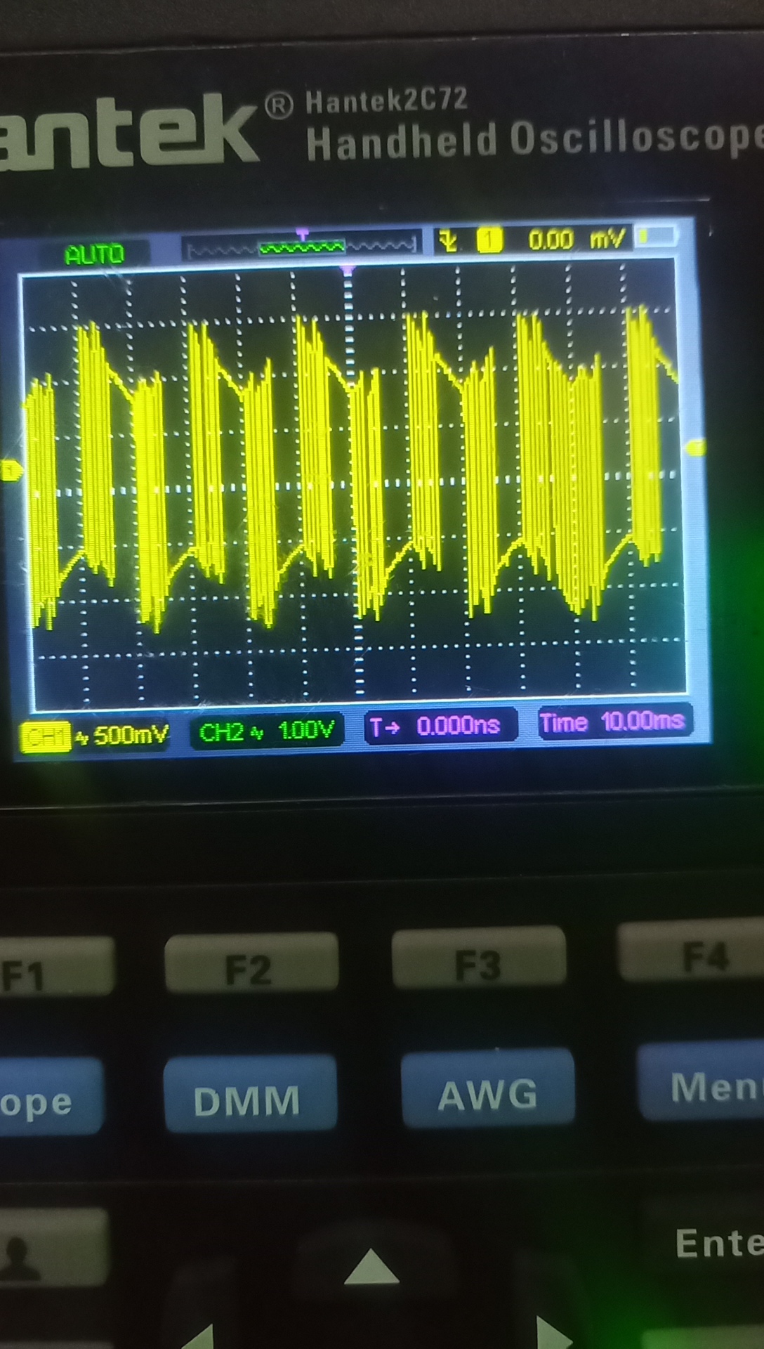

November 11, 20223 yr 4 hours ago, nogers said: Is there a pattern of the correct signal (picture)? I'm not aware of one. It's actually difficult to capture; usually you need two inputs and the "subtract" facility on your DSO. I don't even know how you're getting yours; maybe you should explain, as the signal may be exhibiting artefacts from the connection.
November 11, 20223 yr The transistors are now tentatively just grabbed from the other side and connected via a light bulb for protection. I measure directly with a hand-held oscilloscope. See photo.
November 11, 20223 yr 3 hours ago, nogers said: I measure directly with a hand-held oscilloscope. Ah, OK. If you operate that inverter with real bus voltage, keep your hands well away from the scope, as its reference (negative) input will have high voltage square waves with respect to earth, and it could bite.

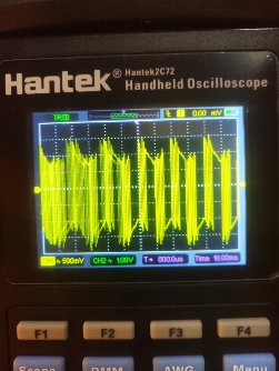

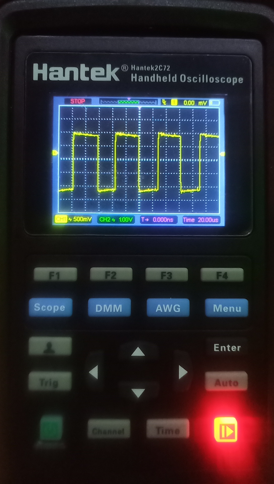

November 16, 20223 yr Hi Coulomb. You're right. The resource is designed exactly as you say. 12V is fine. Only it's not exactly Axpert but some kind of Revo II clone and it's not 100% the same in everything. The curve seems a bit better on the N side and I'm not sure at all on the L1 side of the phase. It's strange to repair (modify) something that has no damaged parts and still doesn't work properly. On the other hand, it is a pleasure to consult such a matter with someone who has such extensive knowledge as you and is still on the other side of the globe.

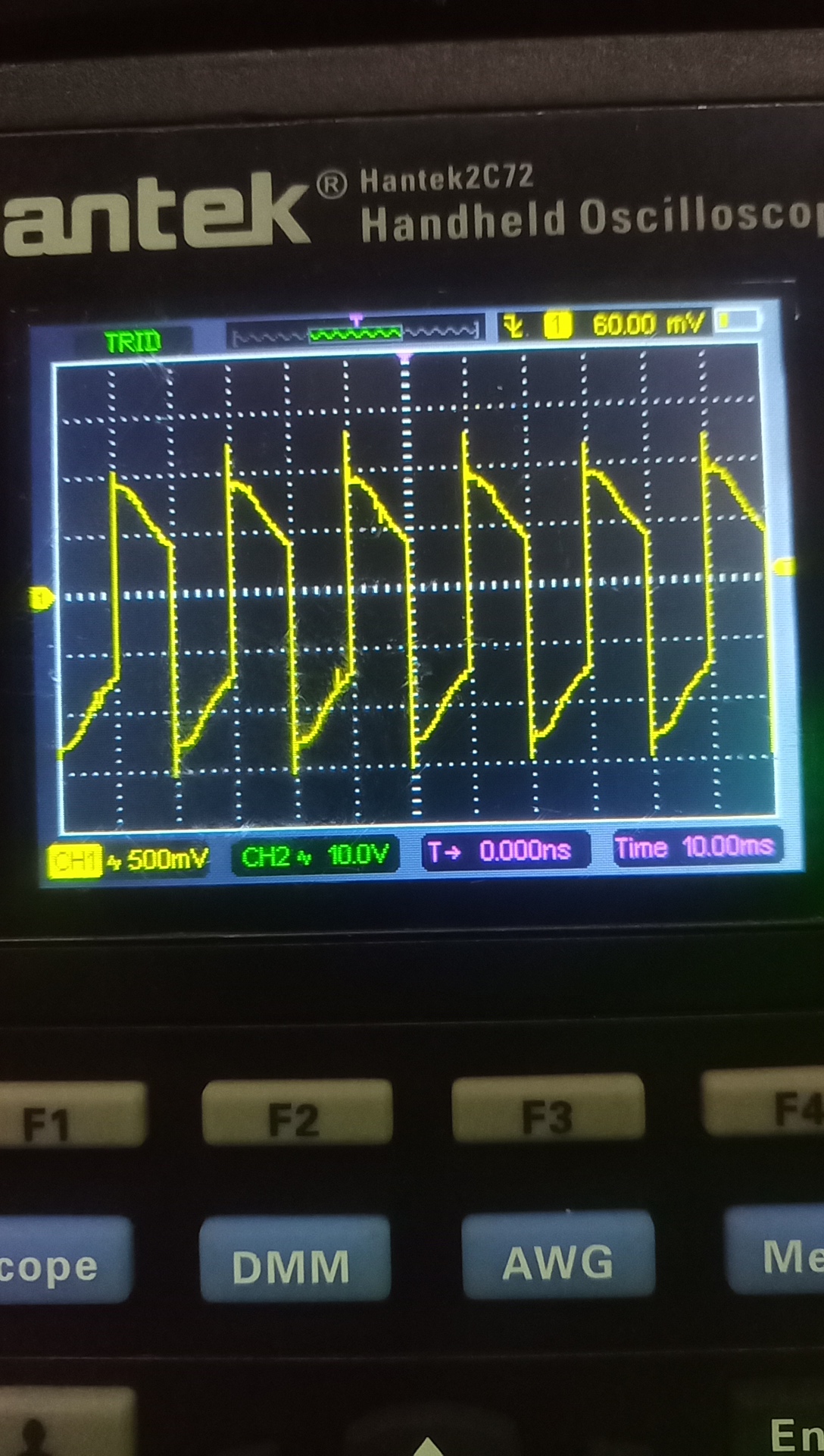

November 17, 20223 yr 5 hours ago, nogers said: I'm not sure at all on the L1 side of the phase. It looks messy because of the PWMing. What does it look like at about 20 μs per division, single shot mode? I'm guessing it will be a reasonable square wave, with pulse width and amplitude varying depending on what part of the 50 Hz cycle you catch it at. That slope is still concerning. Does the 12 V supply perhaps have a trapezoidal waveform on it, averaging to 12 V? It's as if something is loading the power supply more and more as the 50 Hz cycle progresses. The power supply should be operating at many kilohertz, and this should be keeping the gate drive constant at the 50 Hz timescale.
November 18, 20223 yr Hi. At 20μs it is exactly as you say. And the 12v output source on the transformer is trapezoidal with oscillation. also measured transformer tx7 input and output, these oscillations gradually increase. I attach a photo.

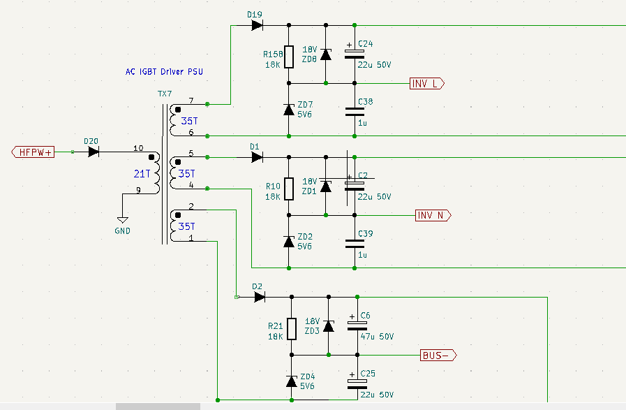

November 19, 20223 yr On 2022/11/09 at 11:23 PM, nogers said: Hi @nogers and @Coulomb , There are unpopulated components on the IGBT PSU sections that just does not make any sense to me. For example some key unpopulated components are R158,ZD4 and R21 on the board-under-test as shown above . The partial schematic depicts the relevance and importance of these components. Could it be that the board was working before for the wrong reasons? EDIT : and there could be more unpopulated components as the third PSU is not captured onto the photo above,. Edited November 19, 20223 yr by BritishRacingGreen
