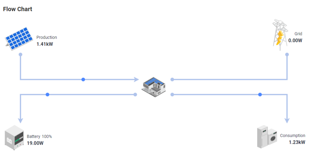

Hi Guys,
Complements of the new year to you all.
I also have the Deye 8KW hybrid inverter with 4x 5.1KWH CFE batteries, 11KWp solar. (Eskom connected, but switched off)
My question is also settings related:
During the day the batteries are usually at 100% Soc by 10h30, and immediately start to discharge to run the load. PV production stops completely 0%.
The Batteries discharge to 90% SoC and only then will the PV kick in to charge up to 100% again. Cycle repeats until the sun goes down
Is there a setting to change the discharge level to limit the discharge to 90% for instance? Time of use settings have no effect.
I don't mind the charge/discharge cycles, but is concerned when the batteries are on a discharge cycle when the sun goes down and I start the evening at 90% rather that 100%
Thanks,
Deon

Hi Mark,
I will try the Grid charge setting and see what happens, with Eskom switched off.
I have also tried changing the priority to Battery first, but it made no difference. It is currently set to Load first
8 minutes ago, DeonB1003 said:
Hi Mark,
Let me know what you find out
Would be interesting to know what "grid" is considered to be. Initial thoughts is Eskom. I know with the Time of Use Slots that if you say set one slot to have a SOC requirement of 30% but there is PV it would continue to charge to 100%. The 30% is just the minimum the batteries must be at for that slot and when Grid Charge is ticked it will use Eskom to achieve this if necessary. Basically Grid Charge does not need to be ticked though for the batteries to charge to 100% for that Time Slot
My batteries are set to be at 100% by 3PM. They normally get there long before that but if for whatever reason PV is not enough it uses Eskom to get it there. I then use Grid charge from 5PM to 9PM to keep it at 100% ( No solar present but busy with cooking etc so batteries discharge ) and then rely on the batteries carrying the house load from 9PM until 7AM the next morning when PV kicks in again. I do have a 3AM to 7AM slot though with Grid Charge ticked and minimum SOC of 30%
I must be honest to date I have not seen my batteries go down to 90% and backup to 100% once they have reached the initial 100%. From the app I can see that there is constantly small amounts of power (100W) feeding in to the battery once at 100%. Again my only difference is I still have Eskom connected
I think there are more advanced settings on the Discharge side of things, will have a look for you to see if I can find them
There are probably more experienced people on these forums who will hopefully reply to you too
I will let you know if it makes a difference.
Before I switched Eskom off, it also kept the batteries at 100%, used Eskom and PV combined to supply the load.

59 minutes ago, DeonB1003 said:
No change with Grid charge selected
HI
What are your settings here?
Your load is using the batteries, there is no eskom, so only PV can replace what is consumed by the load. If there is a configuration setting for when PV starts to replenish the batteries I cant find it
So I currently have loadshedding now ( so in essence no Eskom)
My Panels are still producing power which is powering my load and little bit for the batteries (which are at 100%)
There is is no reduction is the battery %
1 hour ago, MarkZA79 said:
HI
Hi, It's set to "Zero export to CT", No Selling, "Load first". It uses batteries in my case even when there is full sun
